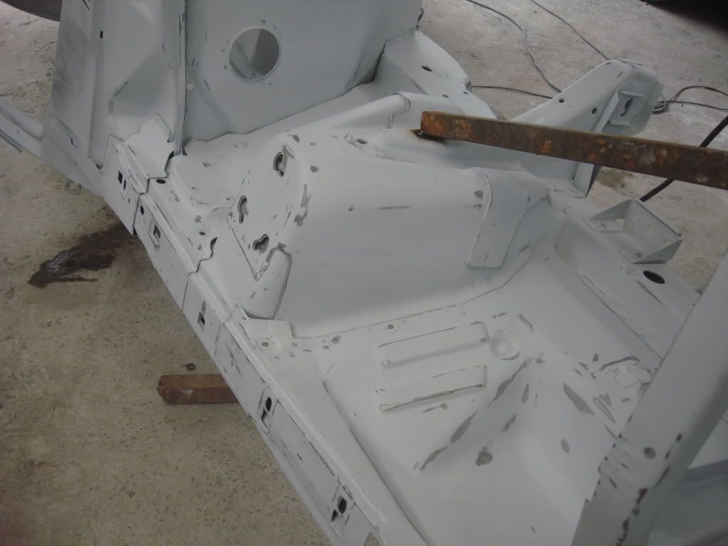

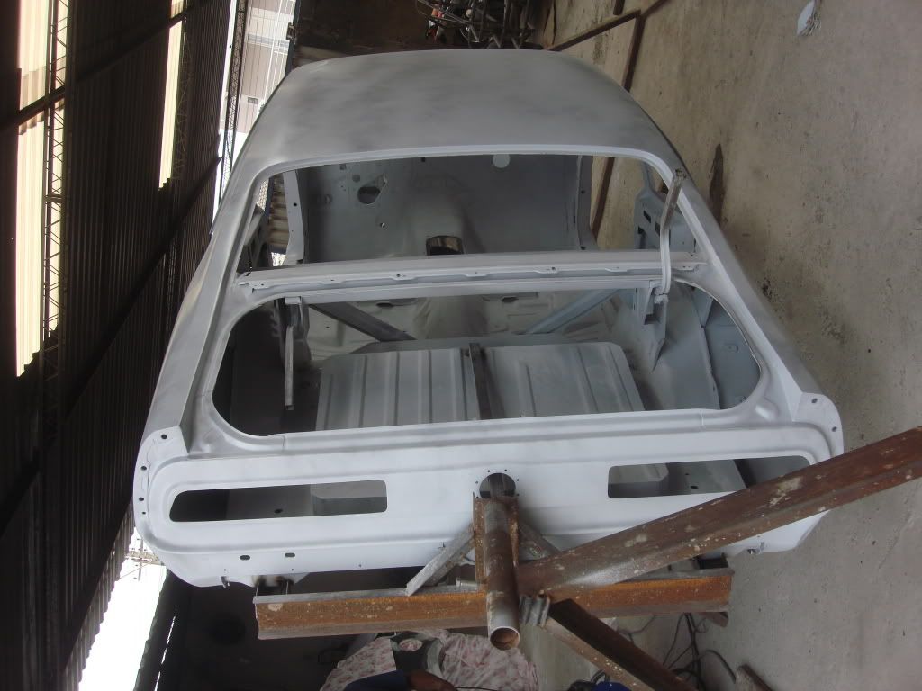

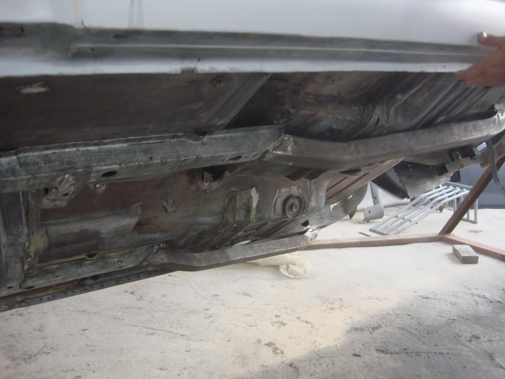

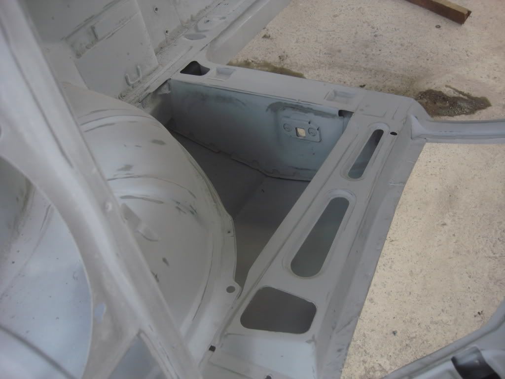

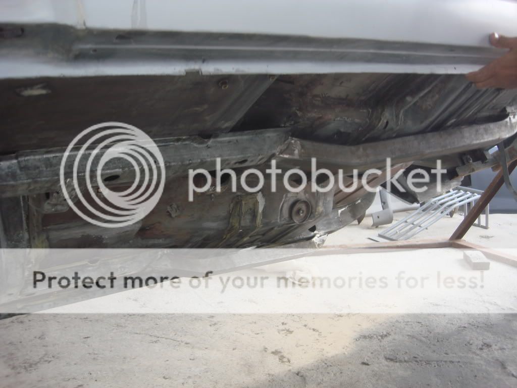

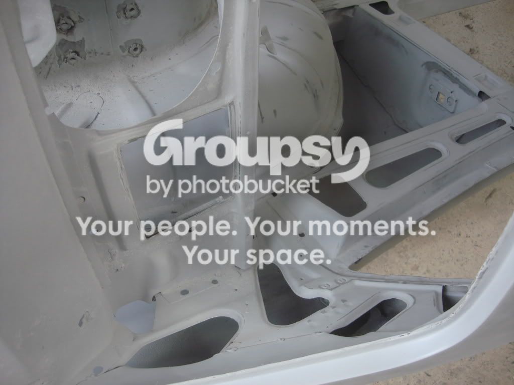

    What are the can shaped things where the fuel tank goes?
  9. topolino
    topolino Member
    Sep 21, 2011
    487
    Brazil
    Chris well observed!
    Although I have changed the tank for a 22 gallon, the tank is still equal to the original, has the hole for the spare.
    And the trunk is now, floor plan, so I did those "cans" to give more support to tank.
    Got it?
    I'll take and install the gas pump that empty space between the tank and the trunk.
    :thumbs2::thumbs2::thumbs2:

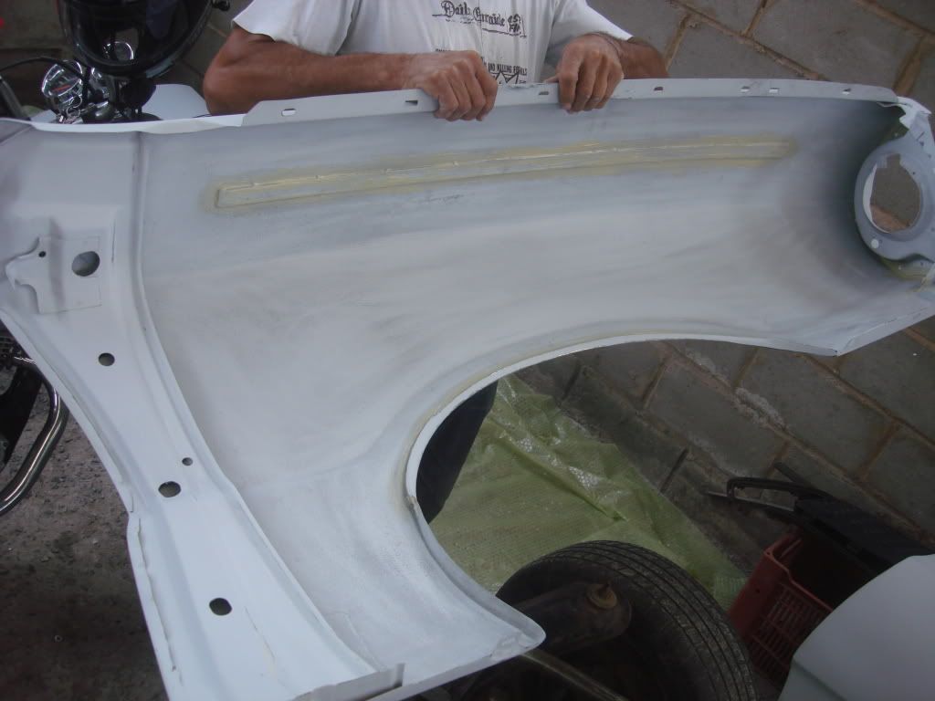

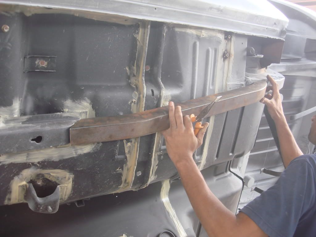

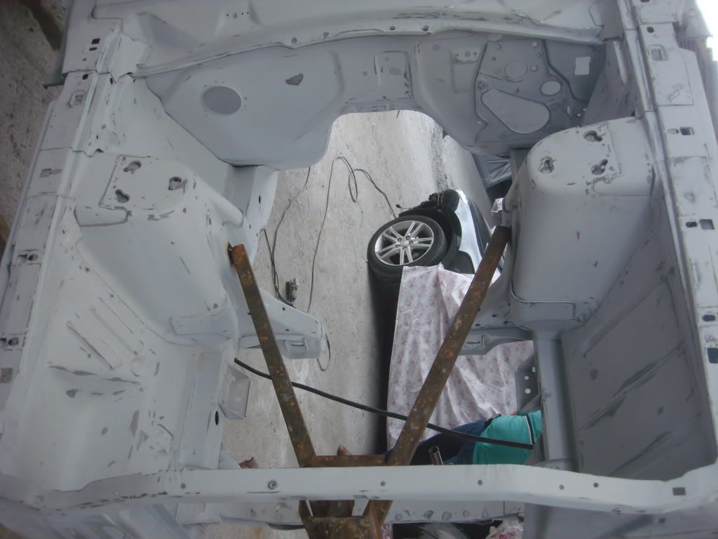

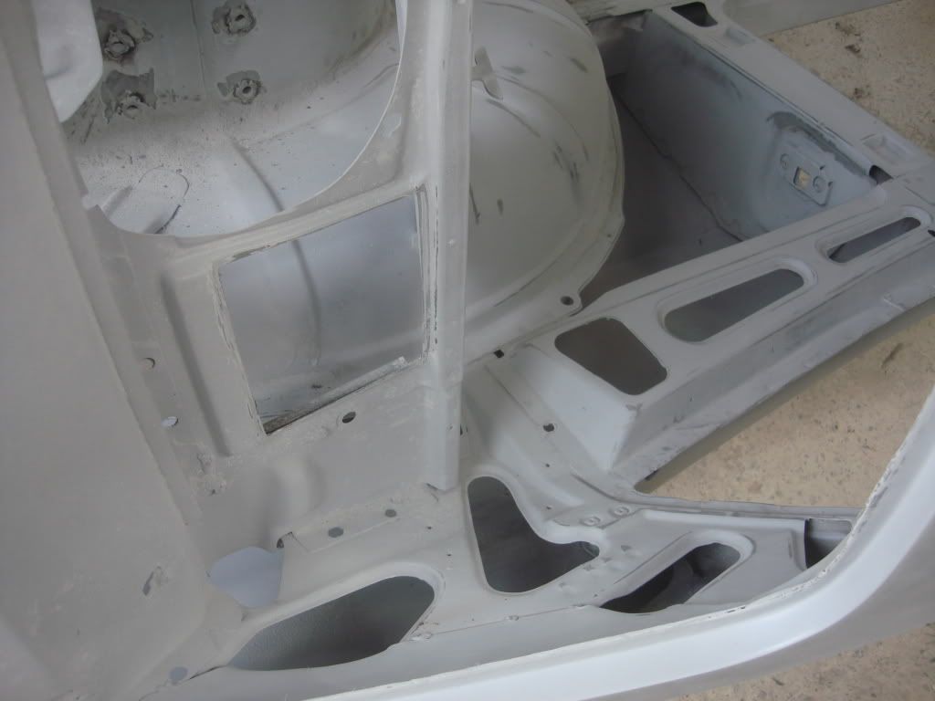

    Did you add the support metal to the top underside of the fender, or was that a factory thing in Brazil? Either way, looks great, and a great idea, as the tops are pretty flimsy without it. :thumbs2:
  11. topolino
    topolino Member
    Sep 21, 2011
    487
    Brazil
    yes,I add the support..to avoid crack the painting..cos everybody loves to put the elbows to see the engine :huh:..then clunk!! I saw this when I buy the car...and prevention is better than cure!:thumbs2:;)
  12. mav1970
    Sounds like a good idea - what size material did you use and how did you fasten it - welding? :)
  13. topolino
    topolino Member
    Sep 21, 2011
    487
    Brazil
    I soldered a strip of 1/8 x 1" x ? .. was very rigid .. I think that will be good!
