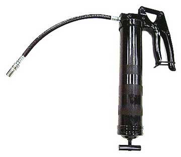

    Hmmm i did post a pic of a cordless drill, grease gun, and grease tube too.

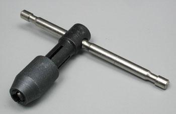

    Yeah, but no (whatever that tool is called that cranks down on the tap) tool.
    This thingamabob...
  13. scooper77515
    Of course, being a cheapa$$, I use one of these instead...and it works in a pinch. Most of the time.

    cheap a$$ or not, both of those would actually be better for the folks that have never or little experience in tapping, they won't break the drilltap as quick. But a drill will tap for all really quick
