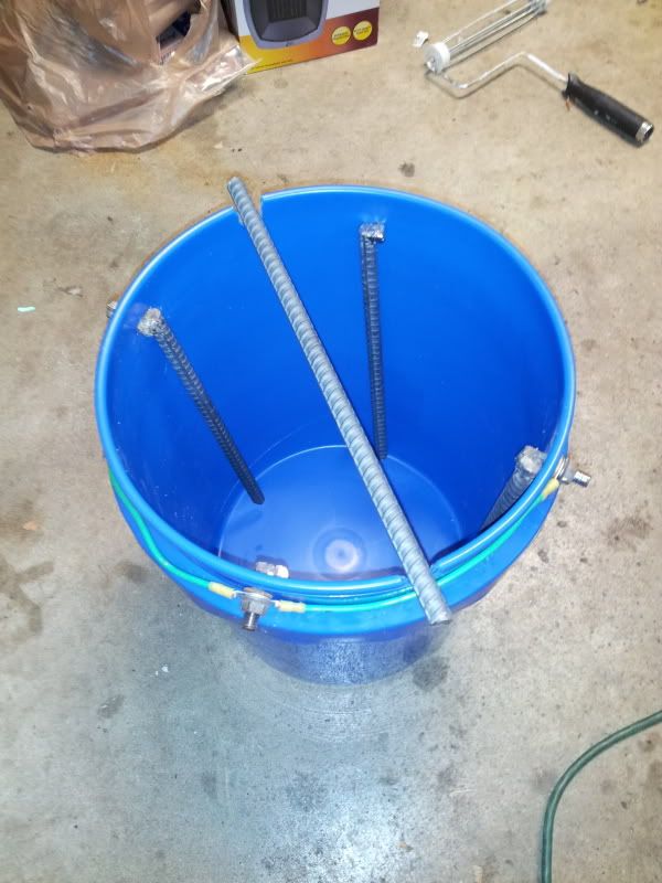

  7. mrmalina99
    mrmalina99 Member
    Oct 20, 2010
    753
    86
    Belfair, WA
    1973 Maverick
    Made a electrolysis bucket.
