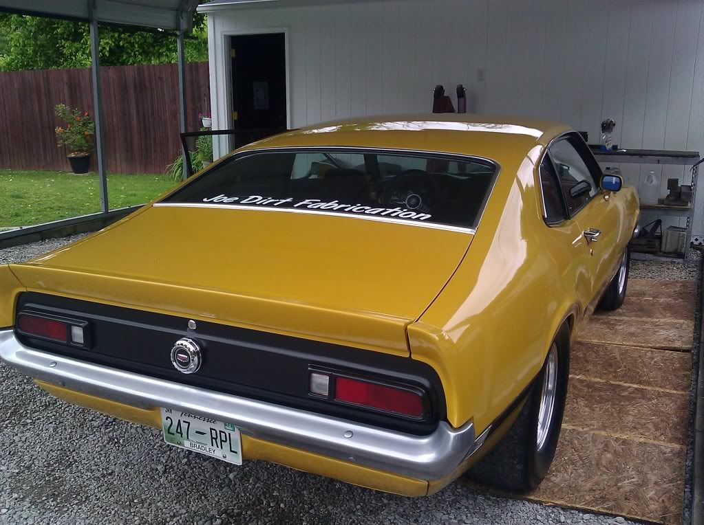

  7. Joe Dirt
    :thumbs2: (y)

  14. Joe Dirt
    Drove it around
