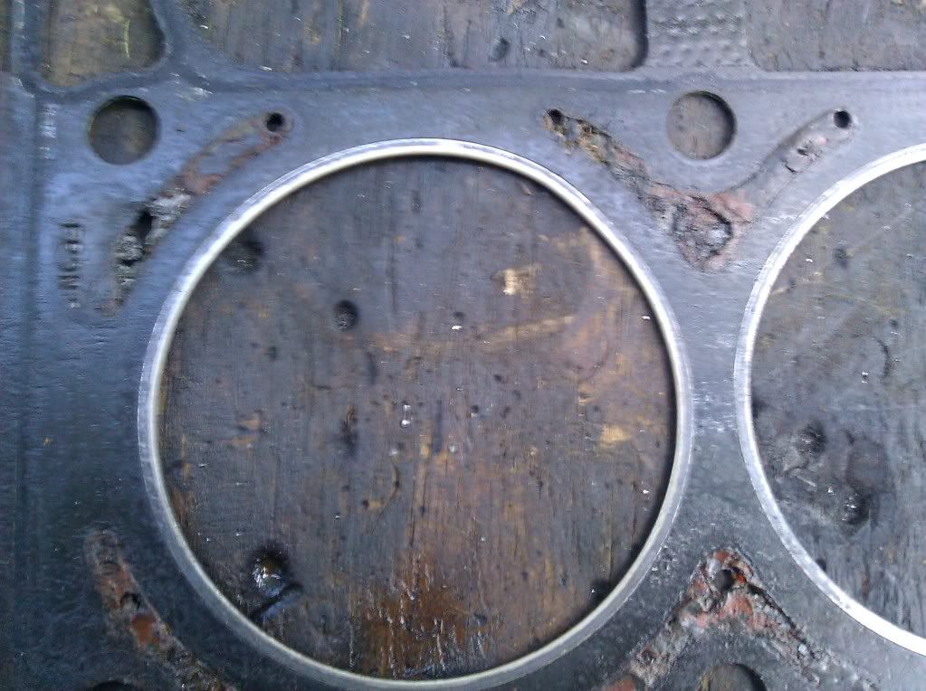

  11. Joe Dirt
    #1 cyl fire ring egg shaped
    can see where the material is pushed "cracked" from the fire ring

    I'd say you dodged the bullet on that one. The fire ring is toast.........
    That is an odd spot........from the picture it looks like wall is totally clean under the spot..........and not so clean above. What did the plugs look like?
    I see studs in your future and maybe a thicker gasket. Are those gaskets .040 or .060 compressed?

    Plugs look great nothing out of line really, talked to a guy about a aluminum 5.3 block tonight would be nice to take that 100 lbs off the nose.i think maybe that cylinder had some water sit in it at one time (i bought it from a salvage yard) debating pulling it and freshining it or slap some gaskets and studs in it
    No idea on the gasket thickness there oem gm gaskets this is the first time ive had the heads off.
