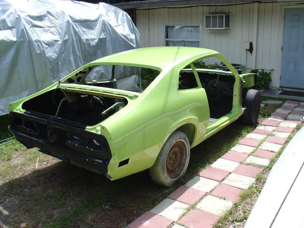

    The problem with clearcoats is the longer you wait the harder they are to wetsand and buff later so you dont want to wait too long because you will tripple the amount of work needed. Here is the readers digest version of what I did after primer.
    Wet sand primer with #600
    Sprayed Lime green PPG basecoat
    Sprayed 2 coats of PPG 2021 clearcoat
    Let sit for 24hours
    24 hours later wet sanded the clear with #1000
    washed, dried, let sit in the sun for 3 hours
    Sprayed 2 more coats of PPG 2021 clearcoat
    Next day started stick sanding with 1000 to 1500 to 2000 to buffing
    Still working on the sanding and buffing part. I wanted to have it done by this weekend but my fingers are starting to hurt.

    A few reasons why. With show car quality clears you can not put on more than 2 coats of clear without the risk of solvent pop. Solvent pop is not noticable from far away, but when you get with 1 foot of looking into the paint you will see little needle like dots all over the paint. The second reason is that clear sprayed on top of clear that has been wet sanded flows like glass which means less wet sanding. Another reason is that when you look down the side of a car and see those waves in the paint, a lot of this is from last coat of clear. Even wet sanding on 4 coats means by the time its smooth the last coat is a lot thicker in some spot and thinner in other places, it tends to act like eye glasses and distorts the clear. When you look down the side of the car at an angle you will see waves. When you shoot two coats of clear let it dry wet sand everything perfectly smooth, the next two coats go on as smooth as glass, when you wet sand this it will be uniform and looking down the side of the car should be perfect.
