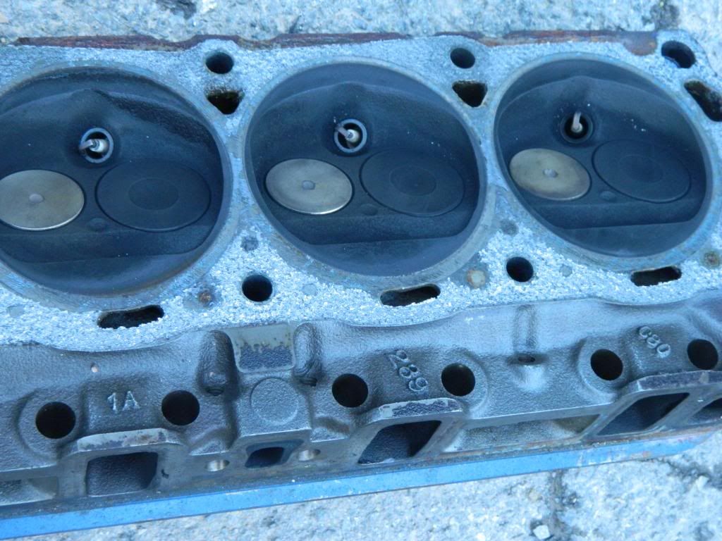

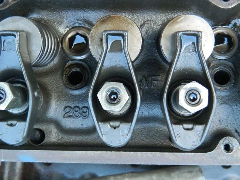

    Got the heads off as well. Here are the pics and following that will be the numbers in text.
    Top of the heads:
    8A18 289 WF
    Under the heads:
    3A 289 C80E
    and
    1A 289 C80

    Looks like those heads have been ported and polished. Might be keepers afterall. Definately so if they are and after you have screw in studs and guide plates installed and get rid of the rail rockers. The pistons look like the stock O.E pistons used in 68. Not sure about the broken castin in the distributor hole, but that might be kosher, they punched out a ragged hole in the front of the lifter valley wall in the small blocks, I'll have to look at the two blocks I've got left to see what they look like there. Are there any numbers stamped into the piston tops ? If there are, that'll be the overbore size. No numbers, it's likely a std bore block.

    Tomorrow I plan it putting on my engine stand and dropping the oil pan. I am interested to see if there is any metal in it. Could someone have possibly chiseled it away a bit, to make room for a larger distributor rod? (Like the HEI that was on it) Another thing, why do the heads have two different numbers on the bottom of them. Mis-matched? Or a different number for a different side of the block?

    I don't see any work on the intake side, but looks like they do have new exhaust valves(maybe intake as well and they're just sooted up)...... Unless someone built a 289 in a '70s block, I'll guess those are the pistons used in a '76 302, remember that block was cast in 1976, heads are much earlier...

    Look at the chamber walls, they've been polished and not their original contours. The 72-76 302 pistons had dished centers that were at least a quarter inch deep. The ones in the pics are much shallower.

    You cannot simply put a larger distributor body in an engine block. Could be someone tried though. It's normal to have some different numbers on two matching heads. The casting (engineering numbers) are the same (C8OE) that's what counts. Look for the overbore sizes stamped into the piston tops. Those are not the pistons used in the 76 blocks. The date codes in the rocker gallery should be close to being the same dates if they came from the same engine. It's the number/letter/number(s) combo next to the valve cover rail that looks like a "screwed in tag" that's actually cast into the head.

    well crap... from the looks of it.. only 1 head has had some work done? Look here and compare to the others. Then compare to the other head which looks completely untouched.
    If that's true and the pic's aren't deceiving?.. those heads will cause compression variations to be all over the place from cylinder to cylinder and even worse from side to side. Not good at all.
    also.. those heads are well over 60cc's(they look like the lo-po 63cc version) and would not be considered anything remotely close to a performance casting unless you start grinding and slicing to get them flowing more and squeezing tighter. Laying the chamber walls back only makes matter worse for compression too.
    Pistons are low compression smogger versions too(granted.. maybe not as bad as some of the mid-70's crap.. but nothing to write home about nonetheless). I'd guess they are aftermarkets with at least an -10cc volume(including the valve reliefs).. and to make matters worse.. they look to be down in the hole at least .015 - .020 too.
    Hate to say it.. but from what I see there.. you'd be lucky to hit 9-1 compression with that setup(I'd guess closer to 8.75'ish MAX). And what's worse.. the cam gear looks to be pretty thin too and should be replaced.

    I missed the variation. Good catch. I only focused on the obvious that they were worked. Those look like the 9 to 1 pistons used from 68 to 71. Definately not the 72-76 units.
