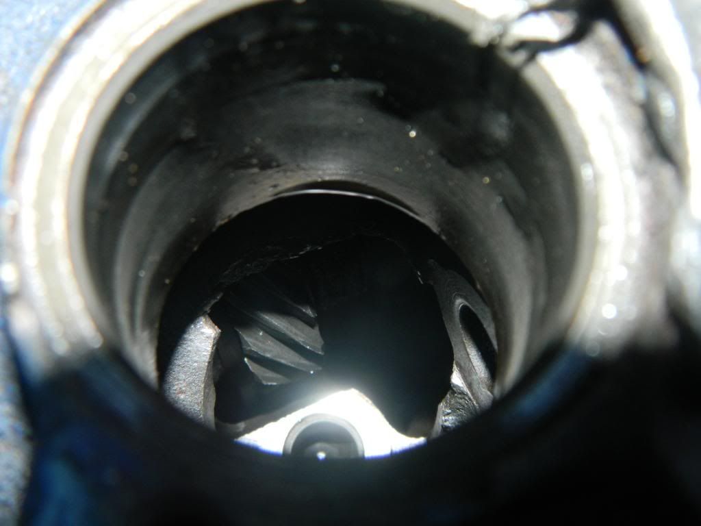

    Take a look at this. Does it spell trouble?
    Found it after I took out the distributor. Any ideas on what happened here? I bet there is a lot of metal in the oil pan.
