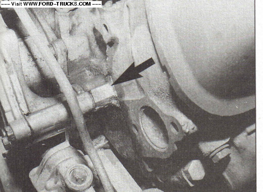

    Real quick - you can at least narrow down the date code on the V8 to see if that is also a 1973. If it was say, a 1971, that would give you solid proof it was swapped in.
    To find the date code, look right above the oil pressure sending unit, which is next to the fuel pump. You will see a small machined flat spot and that is where you will usually find a 4 digit code. It will tell you the year, month and day the engine was assembled.
