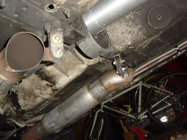

    Hey Rick, you got a bicycle stuck under your car.

    "No, honey. I can't go riding bikes with you, somebody stole mine. You go on ahead without me. :drink:"
