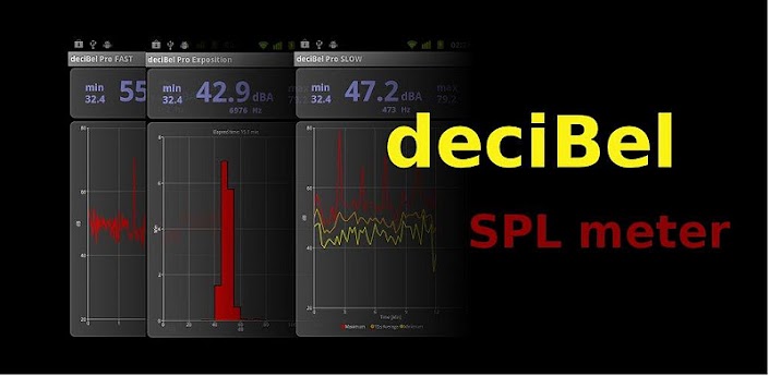

  15. scooper77515
    Just installed this on my phone, but should have used it before I took the exhaust all apart so I could compare before and after and after-after, etc.
