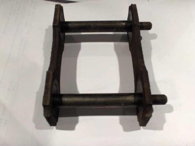

  10. 71gold
    26,589
    2,934
    the frame has a...metal sleeve...in it. if you take that measurment and add the thickness of the 2 rubber bushing lips...that should give you the ...installed thickness...:yup:
    mine were too tight..the top bushings had the lips cut off ...
    Dave, could you get the specs. on that extra set of shackles you have "laying around"?
    thanks...:Handshake
    ...Frank...:drive:
  11. Dave B
    Tell me what you need to know, these are the shackles that were on my 73 when I got it.

  14. 71gold
    26,589
    2,934
    what is the distance between the plates...:bouncy:
  15. JCWGrover
    JCWGrover Member
    May 21, 2008
    17
    Rochester MN
    1976 Maverick Stallion
    Off the top of my head, I believe it should be about 3"
