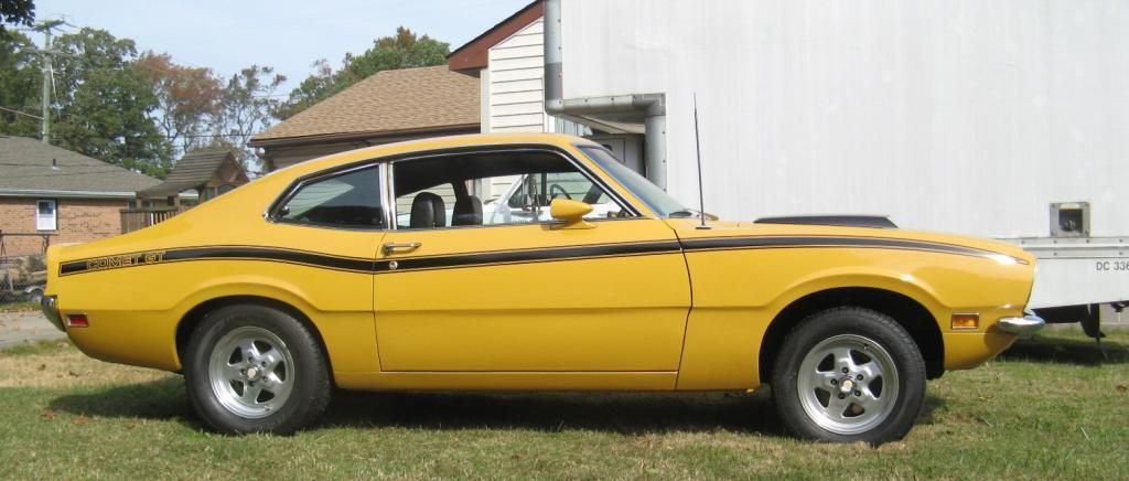

    My car is factory v8 w/ AC, but with the new motor I removed the AC, front bumper/brackets, and replaced intake with aluminum one. So lost a lot of weight up front. That's what's causing it to be that height, they are the factory springs.

    image.jpeg Just wanted to give an update, the moog 8088 springs are most likely stiffer than the trw springs. The car still sat way to high, this was after several hard breaking and some "evasive maneuvering". So I pulled the springs again and took 1 1/8 coil out of the original springs. The car sits MUCH better, probably should have gone 1 1/4 coil but it's good for now. Thank you every one for the great advice and tips! I will eventually get some nicer springs for a better stance!

    Yep. I told you 1 coil wouldn't be enough. It looks a lot better in that picture. Good job.
