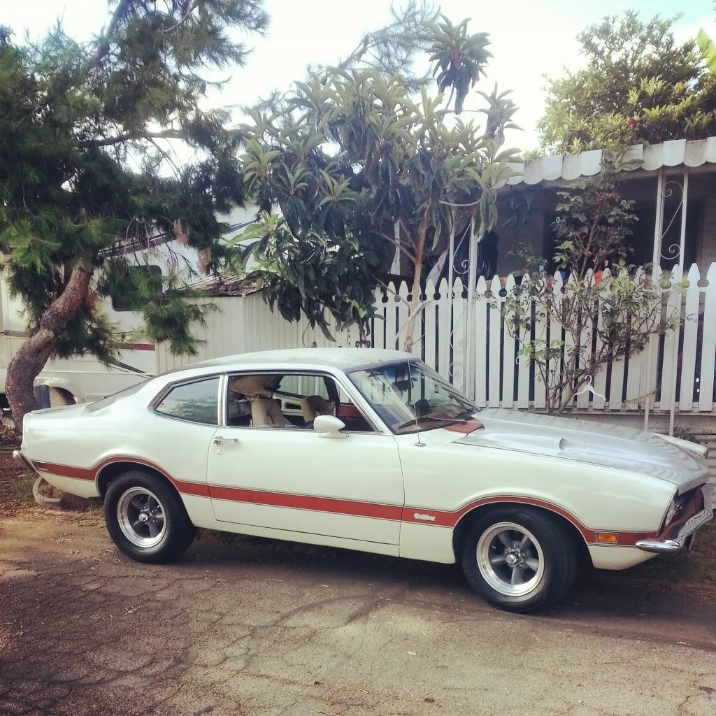

    This is how it currently looks after all the work.
