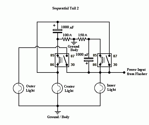

  8. Grabber-1
    Grabber-1 Member
    Nov 17, 2004
    349
    76
    long island ny
    71 maverick
    Heres a cheap way to make them sequence using regular relays that i found on another board.
    i found a clearer picture
