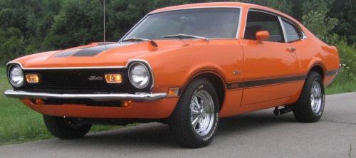

    I have said it before, but I will say it again: I have 4-leaf Espo springs on my car. No ride problems....slight rake.

    I was referring to the height that my car sat. Not so much the ride.
    And no offense, Craig; your car is gorgeous, but it actually sits pretty darn high, which is fine if that's what you're going for, but mine seemed even higher than factory stock. 1-1/2" lowering blocks and there's still a half-inch between the wheel arch and the top of the 26" tire (which is what I wanted).

    Craig
    I think your car sets perfect !!!!
