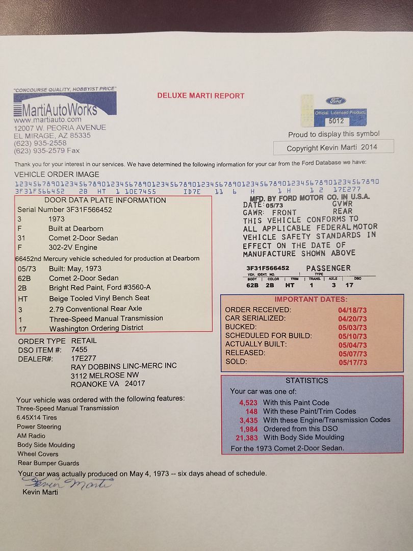

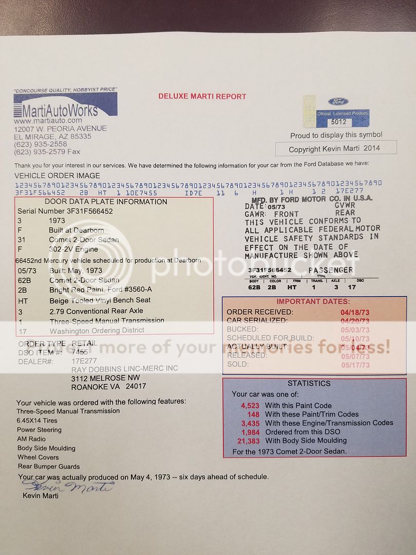

  15. z28th1s
    Jan 28, 2007
    2,334
    563
    387
    Lynchburg, VA
    Here is the Marti Report on my '73 Comet with 302, 3 speed manual and no AC.
