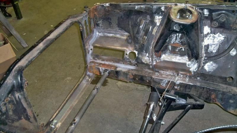

    oooh. i think i might a few more bars to my cage. i like the bars going to the subframe connectors and the shock tower bars.

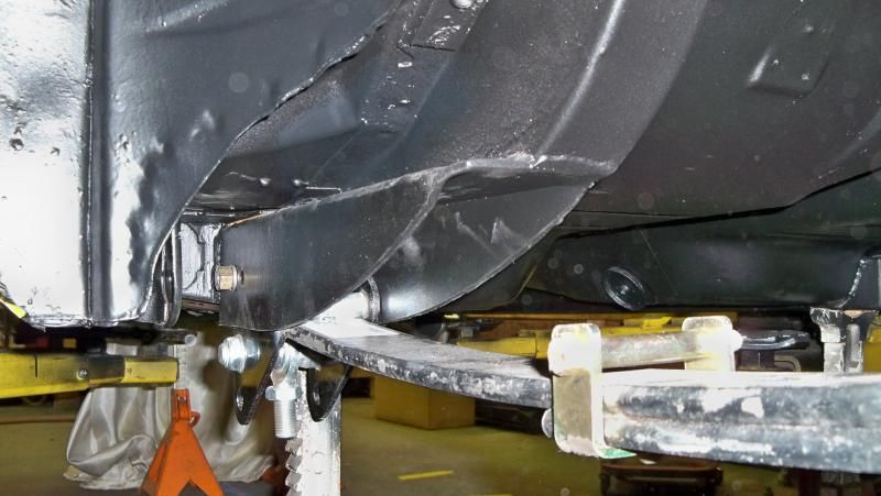

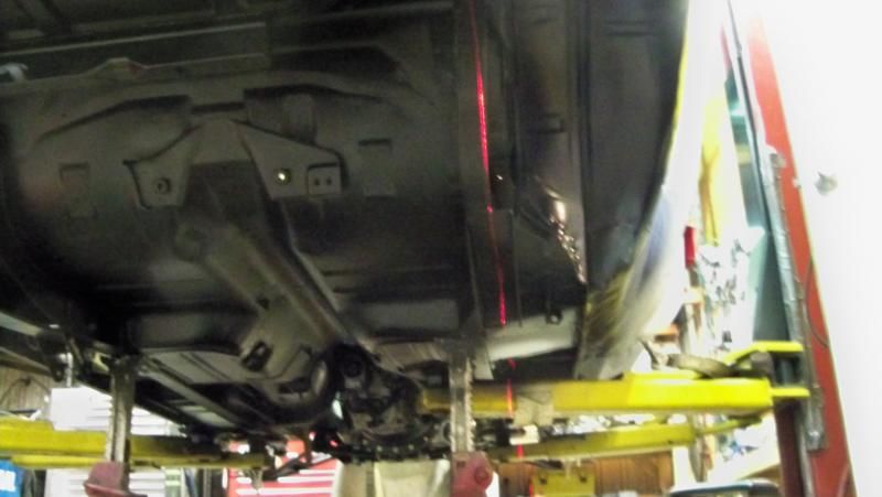

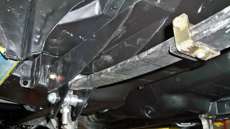

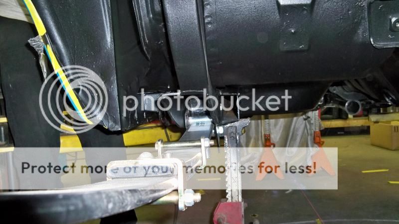

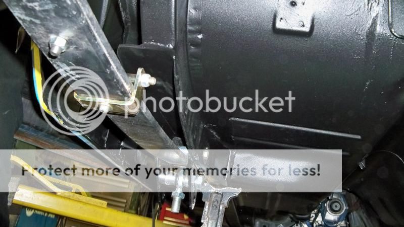

    Here is a few pics of the inboard spring w/ sliders instead of the shackles.
    Using a laser line to keep everything on center.
    And some pics of the drivers side inboard and slider bracket

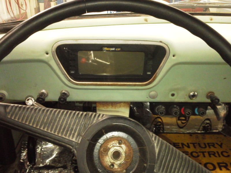

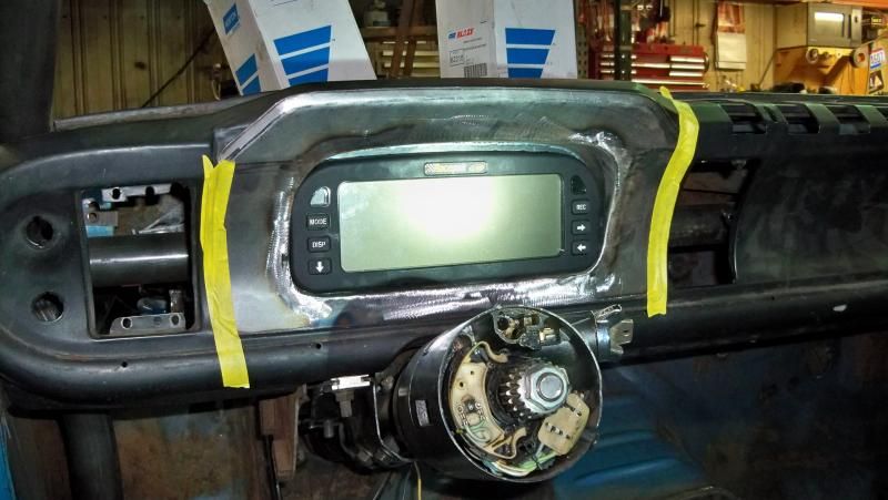

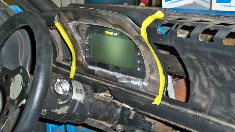

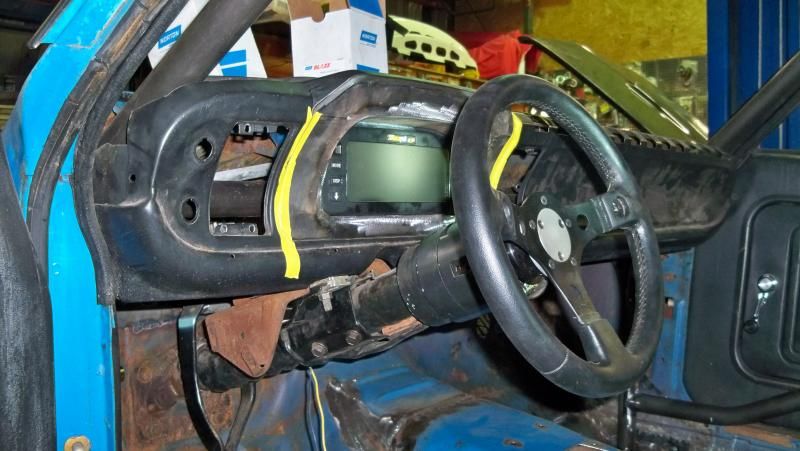

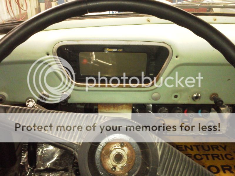

    Here is another one for you, a Racepak dash, and removable wheel.

    Ohhh, I like that, I've been thinking about something like that..

    Interested to see how the dash electronics interact with a car this old as far as speedometer, tach, temp gauges etc. :thumbs2:

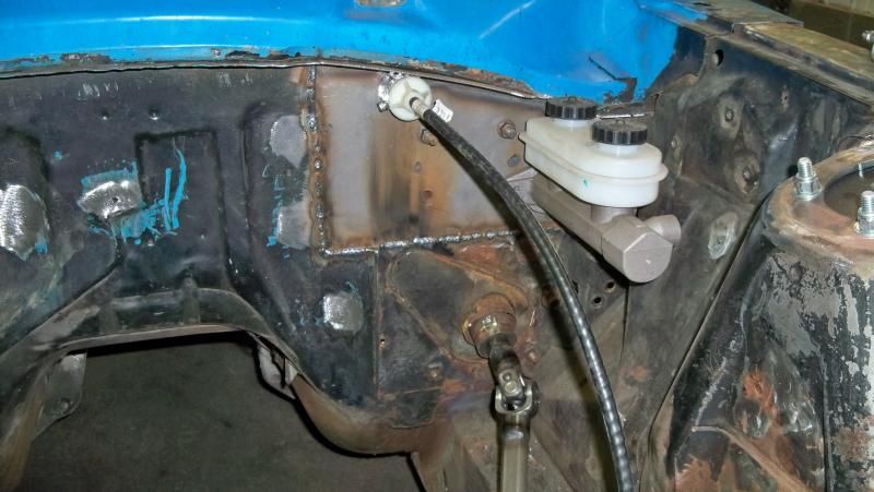

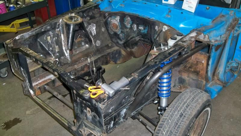

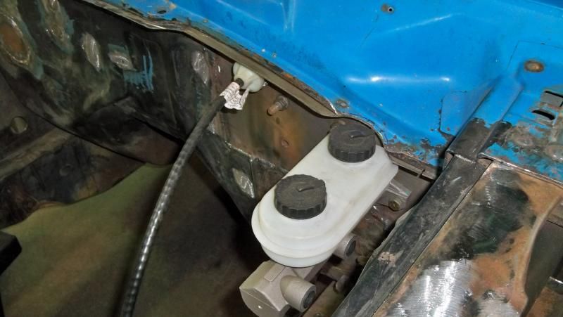

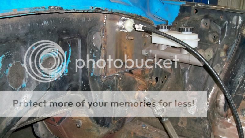

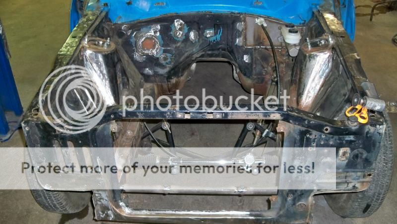

    Here is some of the engine compartment, notice the relocated master cylinder and cable actuated clutch with firewall adjuster.

    The electronics will interact with any car regardless of age, its the wisdom of the installer that makes it happen. If the install sucks in a brand new car it wont work properly.
    here is a similar dash in my 53 f100: works without issue.

    Nice work on the cage! This is very cool, can't wait to see it done.
