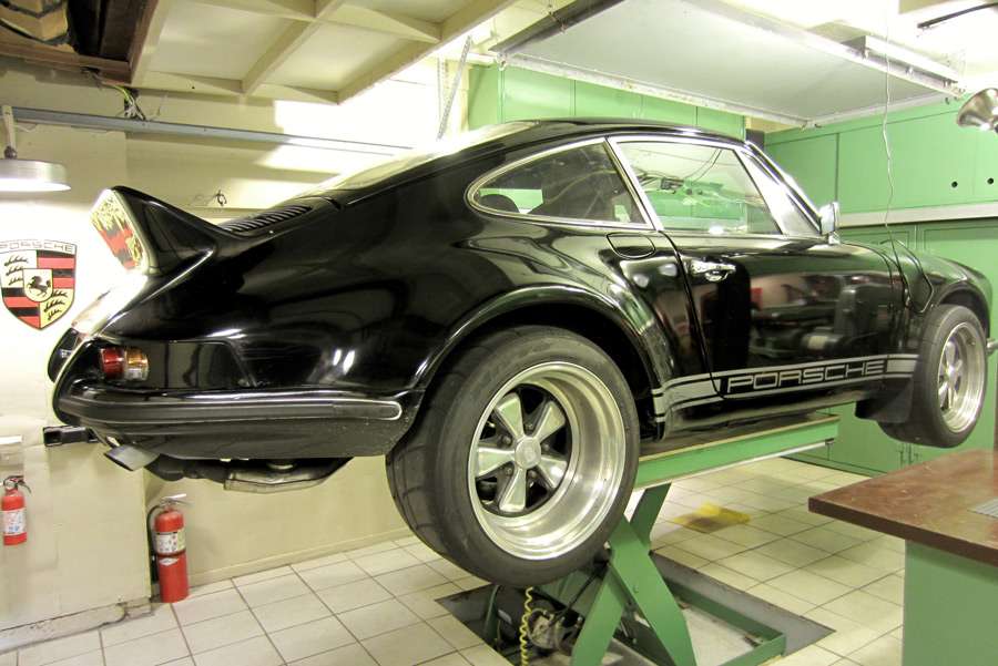

    What really got me thinking about it is a thread on The Garage Journal, this guy has a real nice setup considering the lack of square footage.
  14. Mavman72
    Good usage of space, hope that work bench is on wheels though.
    Love that recessed lift idea but...Gotta have a good drain in that pit. Unless you never get rain or have water/coolant etc on the floor in your shop.
    I do love those Fuches wheels though...Makes me miss my old 944...
