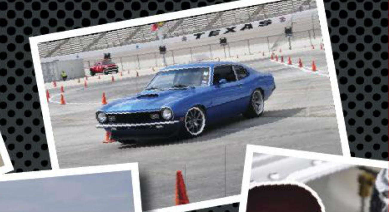

    And the pics just keep "Rollin" in. (punn intended) :tiphat:
    This are pics were taken from the Goodguys Online Magazine
    Get access here. http://www.icloudmobilemedia.com/t/24816
    I gunna need a bigger bar.
    This is a fast smooth turn.
    This is a slower tight turn.

    I could almost swear that I see the front twist in your chassis a bit more than the rear.
    Of course this bar should really help you out.. but what about other chassis mod's being used here too?
    BTW, I've been stalking info and pic's of your car for some time now. Pretty close to what "look" I'm after too. I'll eventually have some mod's and even parts that you may be interested in as well. :tiphat:

    yeah.. but I was referring to chassis flex from the rear forward. Damned unibody's! Gotta love em' cause they're light.. but hate em' cause they're cheap and flimsy. LOL
    I bet a backseat firewall brace would help a great deal there too. Not to mention that car is a prime candidate for a nice cage if not already equipped. ;)

    Thanks
    Monte Carlo bar, strut tower supports, and subframe connector system.
    Not the best for building torsional stiffness
    But something like this just isnt in the budget.
