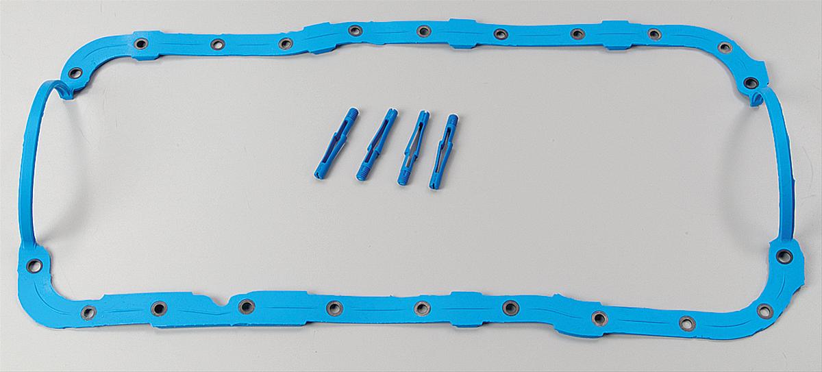

    I used the one-piece rubber re-usable ones from Fel-Pro, with the metal in the middle and soft blue rubber elsewhere. OF COURSE, it would't hurt to retorque everything after the past year of running it after a fresh rebuild.

    from your sig ill assume you have a one piece rear main seal block. i wouldnt expect the rear main seal to leak when not running. on thing that may be a possibility is oil is leaking from where the rear main cap meets the block. i usually assemble these with a film of sealant on all the contacting surfaces to prevent oil from getting through.
    as long as your sure its not coming down from the top of the motor, it sounds like you need to pull the transmission and try to see where the oil is coming from.

    I used that type of gasket on my Falcon...and it leaked. I went back to the old school gasket and it fixed the problem. The new style might work if the engine was upside down on an engine stand when installed. Trying to hold a heavy gasket in place before getting the pan installed...gravity wins every time.

    It was installed while upside down on an engine stand.
    The transmission will come off in the near future for a converter swap (when weather dries up, but is still cool). I will get a better idea of where the oil is coming from then.
    Until then, I might just retorque all the oil pan bolts and see if that fixes it, or at least slows it down.
