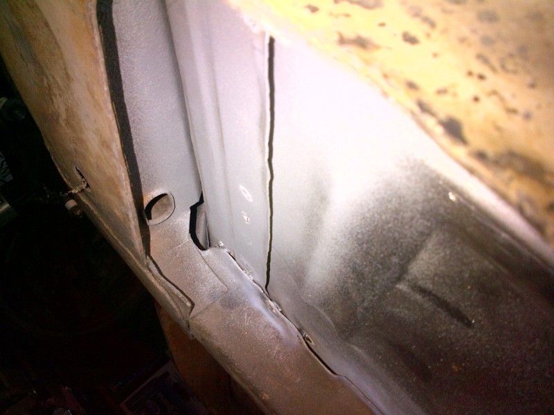

    Well, I'm far from a good welder, it's kinda hit and miss, plus my mig welder is dying a slow death. Since It was a holiday today thought I'd give it a go....
    Thank goodness, I'm good with a grinder, a little clean up and it'll be fine.....A little gap filling, and I'll be happy.

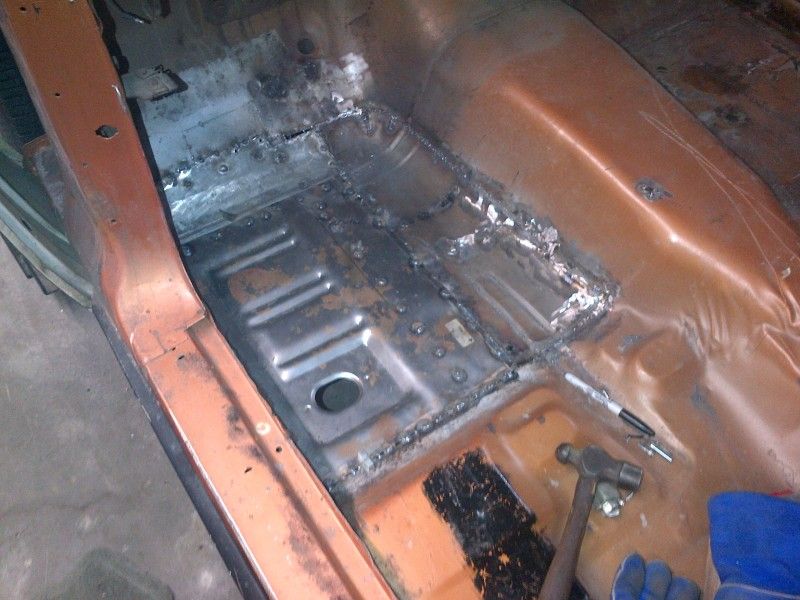

    Ah hell thats about what my patches look like. Just takes a bit more to clean em up thats all. Fits nice though.
  4. mercgt73
    Lookin good, Dave. What year Mustang panels did you go with?
  5. Dave B
    Thanks!, They are just the generic 64-70 short floor pans, but since Mustangs are wider, I rebent the side to center it up between the rocker and the frame rail.
  6. mercgt73
    I like that idea. I also have to add the inside curved piece like you did. My toe panels need to go farther, but they can be just flat sheet metal also.
  7. Dave B
    I tried to make it look like they did from the factory, so I make the front piece separate, and gave it a small lip, so when you look under the car, it looks factory.
    I sprayed some weldthru primer on the welds, just to stop any rust, it'll be next week before I get back to it.

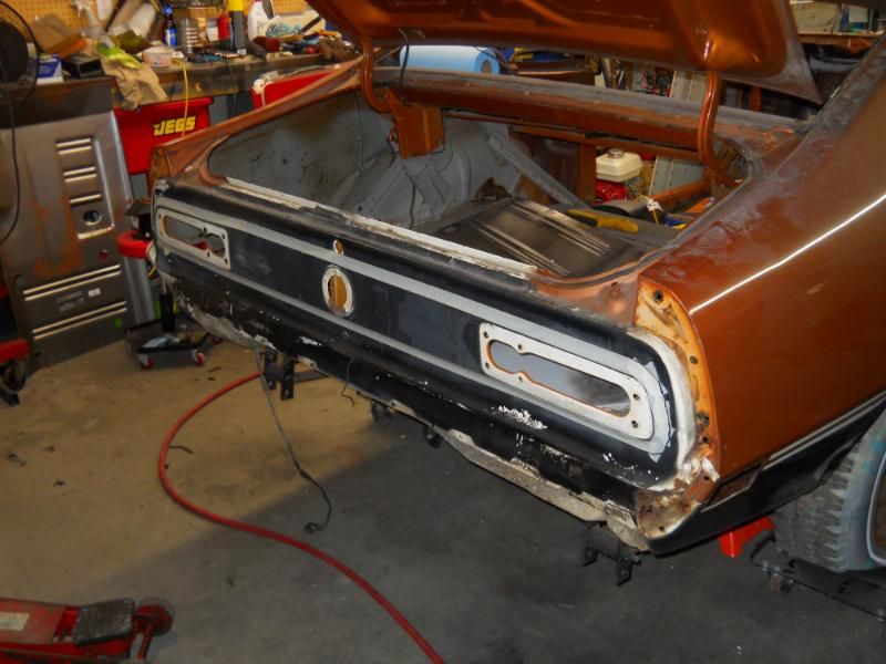

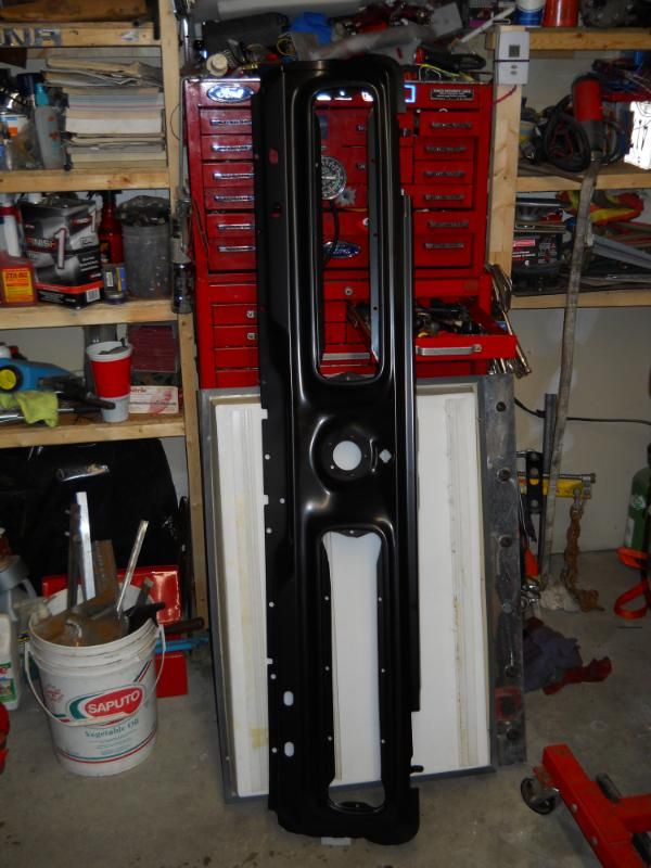

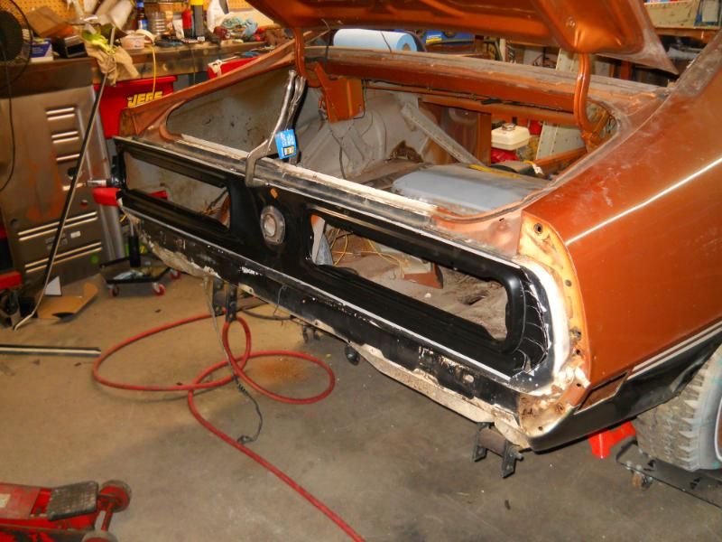

    I picked this up the other day, while in Detroit.
    Since there was nothing on TV today, I figured I'd lay it out, and see what it looked like...
    Before I knew it, this happened....
    So, it was the point of no return.....
    A little more trimming and fitting, and I'll start welding it in.
