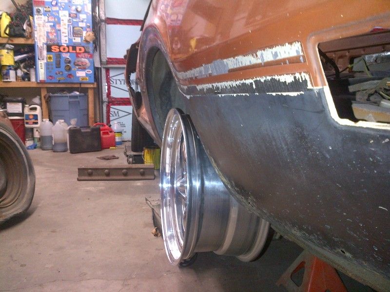

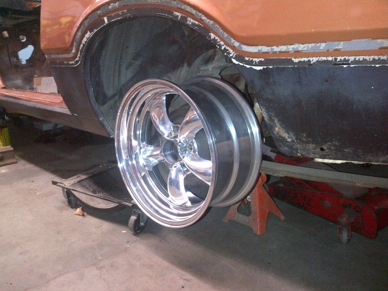

    I haven't been it the mood to do much, so I figured I'd give myself a little motivation, and just double check that my rear wheels will fit the car...I had some slight concern, since this is a 17X8 rim....with a 4 & 3/4" backspace.
    They have real close to 1/2" of clearance to the axle tube snubbers...so maybe when I finalize the width of the Explorer rear end, I can push them out a little...or trim them.
    Should be nice and wide......and sit up inside the wheel lip.

  10. Mavman72
    You may do better to relocate the snubber Dave...Sidewall bulge is gonna eat up any space you think you have...Especially at the springs and at the quarter lip...Time to roll the lip...
  11. Dave B
    Off it comes!!!! :)
  12. CaptainComet
    5,012
    453
    You probably know this already, but, another area to look at is the inner wheel tub near the front. That is where my inner sidewalls barely scrub if going up an inclined driveway, etc.
    Those wheels look like a pretty good fit from the pics.
  13. Dave B
    Maybe this might lead to some mini-tubbing..:rolleyes:
  14. car-nut
    car-nut Glenn
    Jul 2, 2006
    1,299
    conn.
    Dave I was sooooo close to doing that to my car. But the floors and everything were so nice and clean I just couldn't cut them. If they had been in need of any work I would have though.
