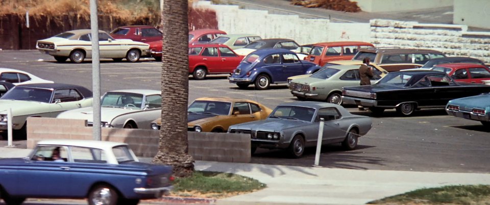

    Was doing a search for Rambler engine swaps and came across this

  10. yellow75
    Jun 10, 2004
    4,782
    1,171
    587
    Tillamook Oregon
    Thats a cool pic, its got the Rambler a Grabber, Comet GT and possibly another Maverick. Love those old pics
