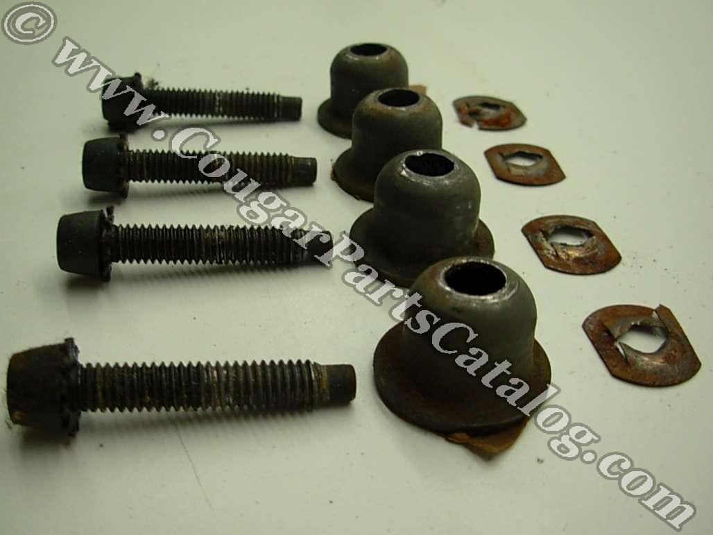

    High Back Bucket Seat Track Spacers and Adjuster Knobs
    High Back Bucket Seat Track Spacers and Adjuster Knobs.
    If anyone is looking for some of this hard to find Hardware:
    *Some of the 67'-70' Mustangs and Torino/Cougars used some of the same "bell shaped" and larger style seat track spacers.
    As far as the "Bell Shaped" seat track spacers...
    West Coast Classic Cougar sells used "bell shaped" ones:
    (* Factory P/N C6OZ-6362016-A, and they have alot more info on them)
    http://www2.cougarpartscatalog.com/seatextender.html
    The larger type Spacer on some of the 67'-70' Mustangs and Torino/Cougars:
    (And it's original Ebay listing):
    http://www.ebay.com/itm/1968-1969-F...Parts_Accessories&hash=item4616929ac5&vxp=mtr
    Here is an expired ebay listing that also had the bell shaped spacers:
    (*Scroll down within the Ebay page, after clicking on the link below, to see the original listing)
    http://www.ebay.com/itm/67-1968-196...D&orig_cvip=true&rt=nc&_trksid=p2047675.l2557
    West Coast Classic Cougars also sell reproduction seat adjuster knobs, for the high back buckets:
    http://www2.cougarpartscatalog.com/65a-6261753-21.html
  15. CaptainComet
    5,011
    452
    That is very interesting to see these spacers in use in other Fords.
    After looking into the bell-shaped spacers on the West Coast Cougar website, it looks like these were used between the seat track and the seat to give shorter drivers a better seating position. Mavs and Comets use them between the seat track and the floor, and that requires longer studs on those two tracks. Far easier to use longer seat bolts in a retrofit situation at the dealer, because the seat tracks have the floor bolts pressed-in.
    The block-type spacers ... definitely going to have to look into more specifics on those.
