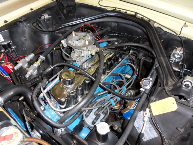

  12. Mhackett
    Mhackett Member
    Aug 2, 2012
    86
    Rochester, NY
    1969.5 Maverick
    My I6
    This is mine with the 2bbl weber, HEI ignition and cold air intake
  13. 71gold
    26,589
    2,934
    what makes that a..."cold air intake"?
  14. Mhackett
    Mhackett Member
    Aug 2, 2012
    86
    Rochester, NY
    1969.5 Maverick
    In theory, it sucks cooler air from the non exhaust side. Don't have the money right now to extend the pipe to the front of the car.
