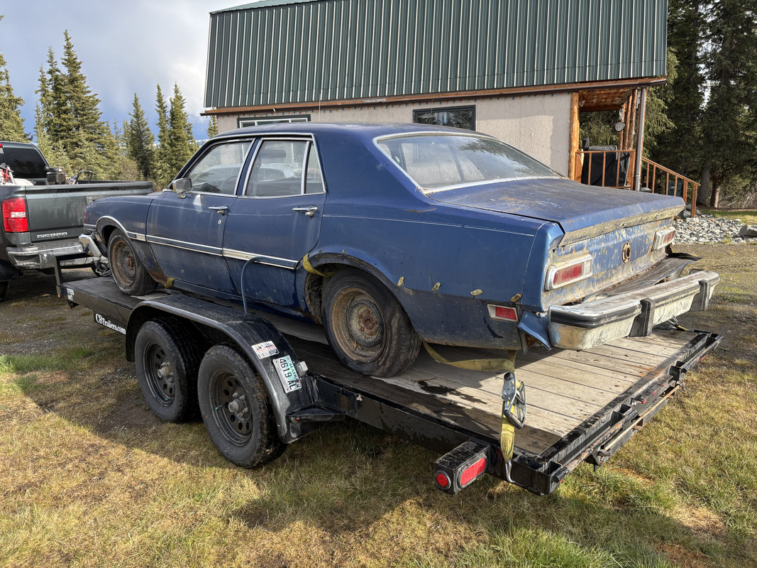

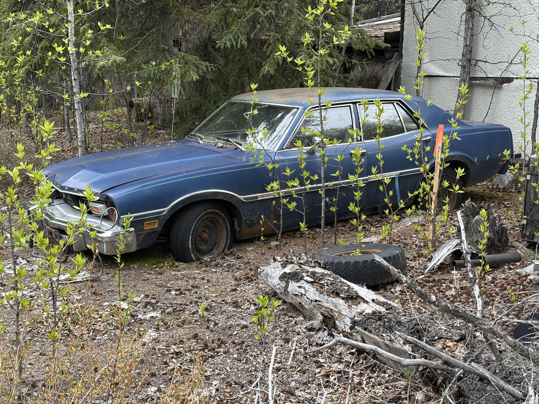

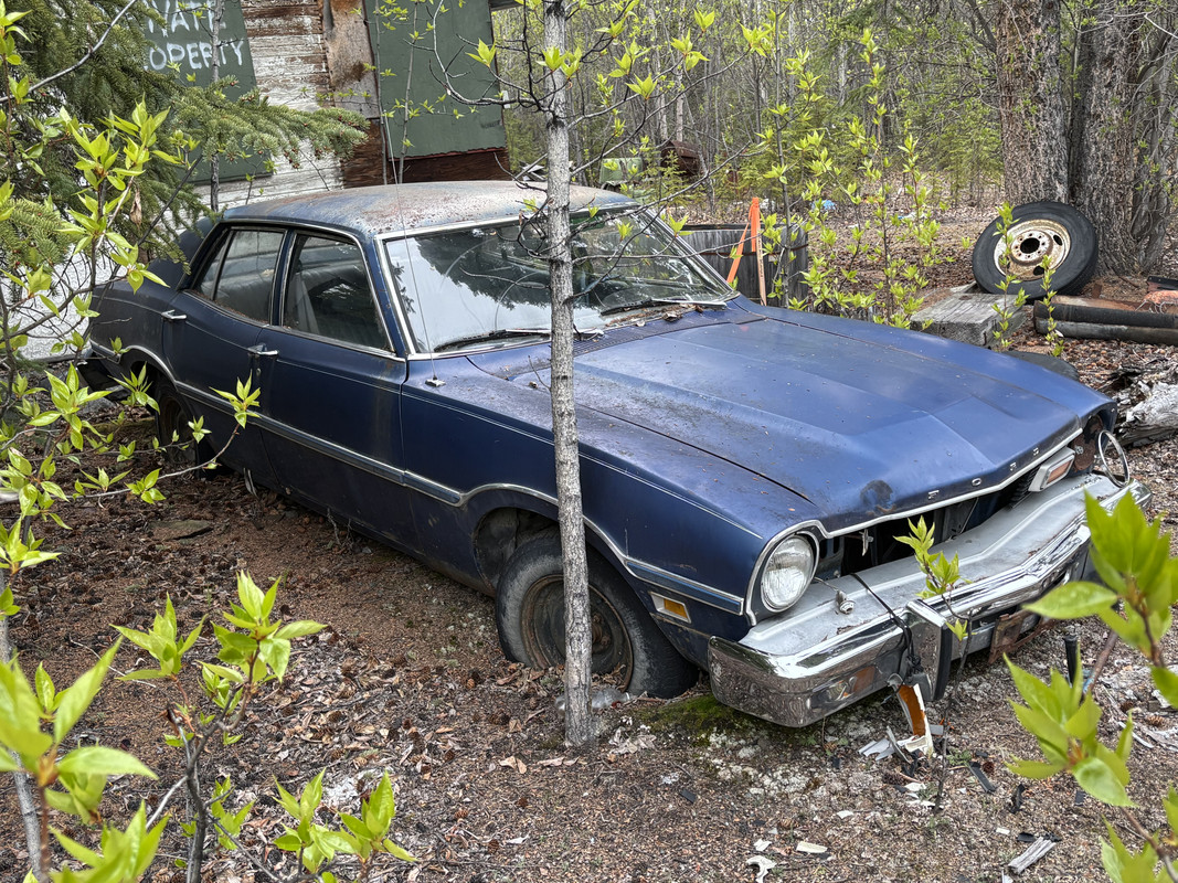

    Hey guys, I got this Maverick given to me. From what I can find, it’s a 75-77 from the “Ford” across the hood and larger bumpers, but I can’t find anything to narrow it down beyond that. Zero history on the car. Grille is broken and gauge cluster is missing, but in pretty good shape otherwise. Inline 6 with an automatic, engine still turns over. I’ll be picking it up soon and will have better pictures then.

    First digit of VIN will be year. 6X92L1xxxx would be 1976, X = St Thomas build (K = Kansas City)
    L=250 6cyl, U would be 200.
    Looks like she's been setting for years, has little Maverick sprouts coming up all around it. :yup:

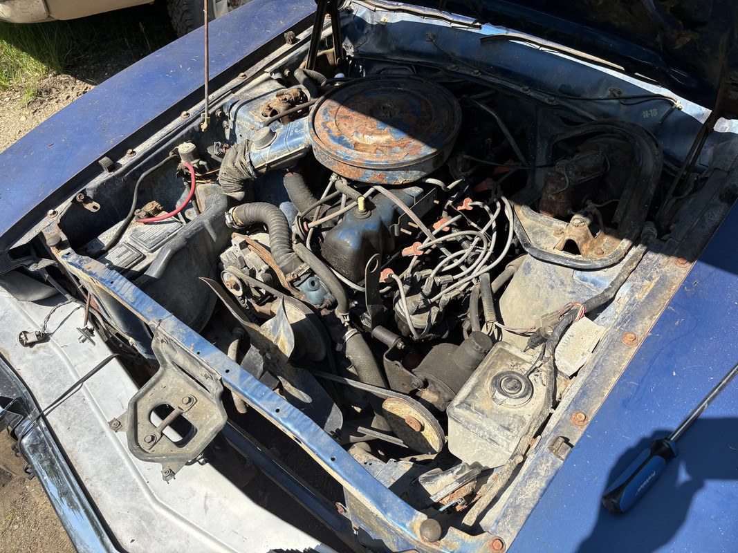

    Could I use a radiator from any of the above cousins? I’m not as familiar with Granadas, but the radiator looks Mustang-ish.
    The rear damage looks worse in the pictures than it actually is. The bumper is bolted on, but in the wrong way, and the mount is a little bent. The rear will take some massaging, but I also know of a rolled 2 door Maverick I could probably cut some metal from if needed. I’ll straighten it out as much as possible first, though.

    Rad would be similar to '67-'70 Mustangs. Fox body generally have cross flow radiators, with work probably useable.
    Radiator size can vairy due to engine, A/C etc, here's a size chart. Height, thickness and width
    BTW I think 200 uses smaller hoses than does 250. Powerband can probably verify.

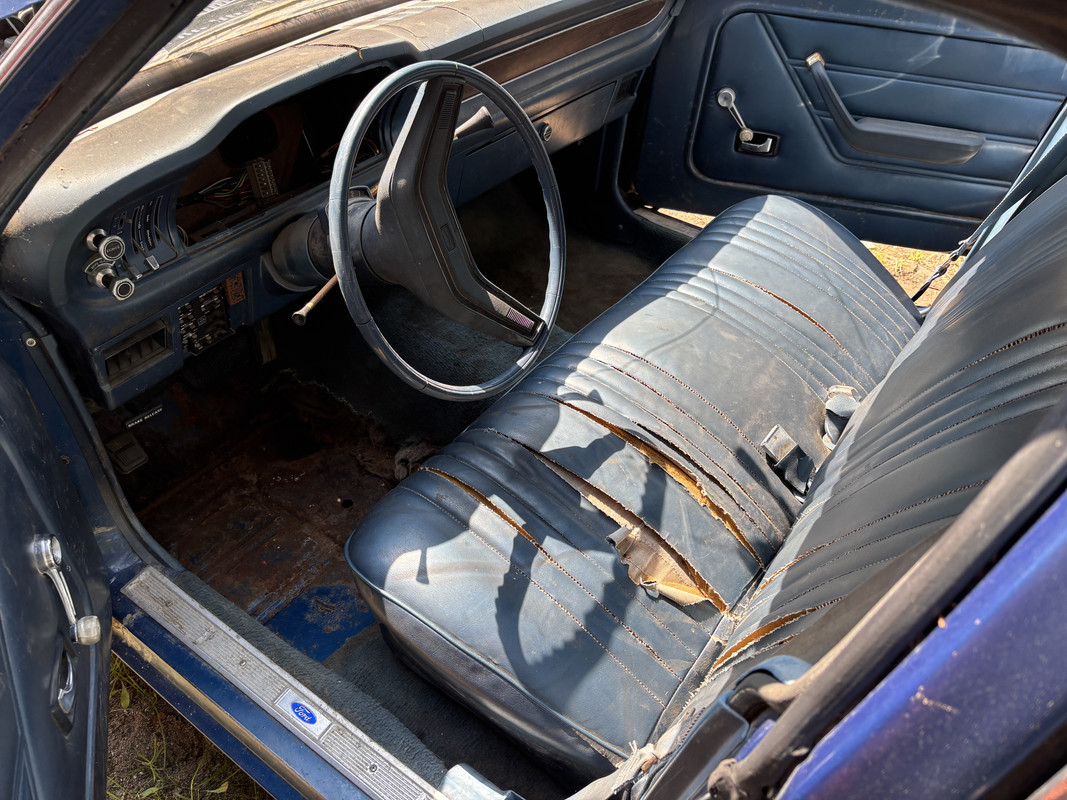

    It was a nice day out, so I worked on the Maverick and a few other projects. Replaced the ignition lock switch.
    Vacuumed out the car, it cleaned up pretty well!
    Managed to get the hood open, I’m guessing there is supposed to be a release cable somewhere? Turns out it’s a 250, at least according to the valve cover tag. I dumped some gas down the carb and connected a battery, and it runs! I didn’t want to run it too long without a radiator, but it also seemed to go into gear as well.
    Next steps are to track down a radiator, and get some tires on it! Then a tune up and much needed bath!

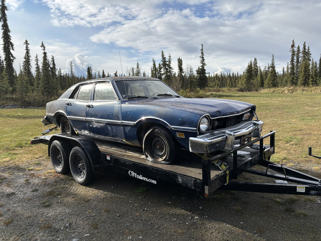

    I’ve been slowly doing some more work to the Maverick. Picked up a good set of tires for the stock wheels.
    Wiped the car down and installed the factory hubcaps.
    Installed an aluminum radiator.
    Took it out for a test drive! It runs pretty decent, seems to shift fine. Reverse works. Brakes work. Even the headlights work!
