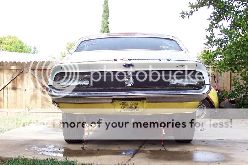

    I got the rear bumper done last evening right before the rain, so i thought I'd post a couple pics.
    I'm gonna try to get to a locksmith today to have him re key the trunk lock, so I can ditch the bungee deal.
    The bumper has a slight buldge to it in the lower right hand corner, but i can live with it for now.(y)

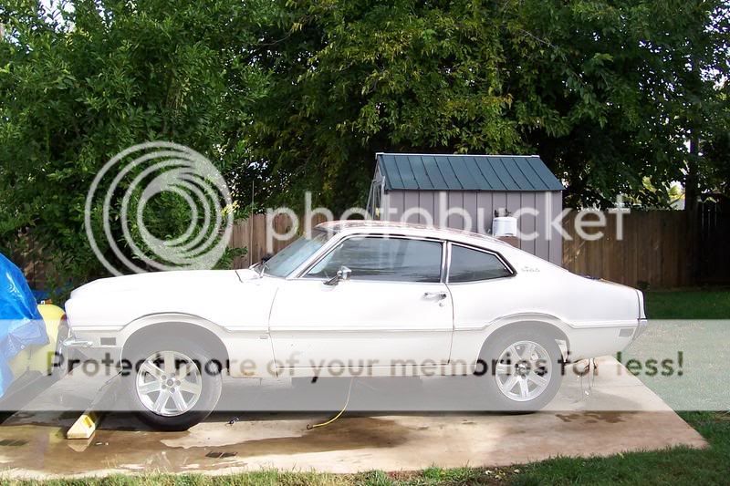

    Side shot
    Don't mind the wheels, they are coming off.
    Overall I think the swap came out pretty good. I had my wife help me line up the rear bumper. she sharpied the bolt holes while I held the bumper, then i drilled the holes out with a stepped bit. we did one side at a time so that we could eyeball it out. Four eyes are better than two I say. :thumbs2:
