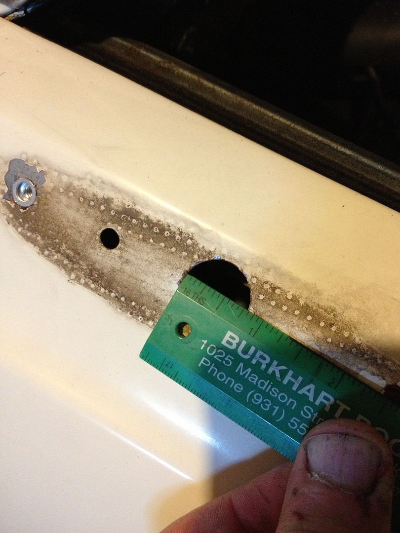

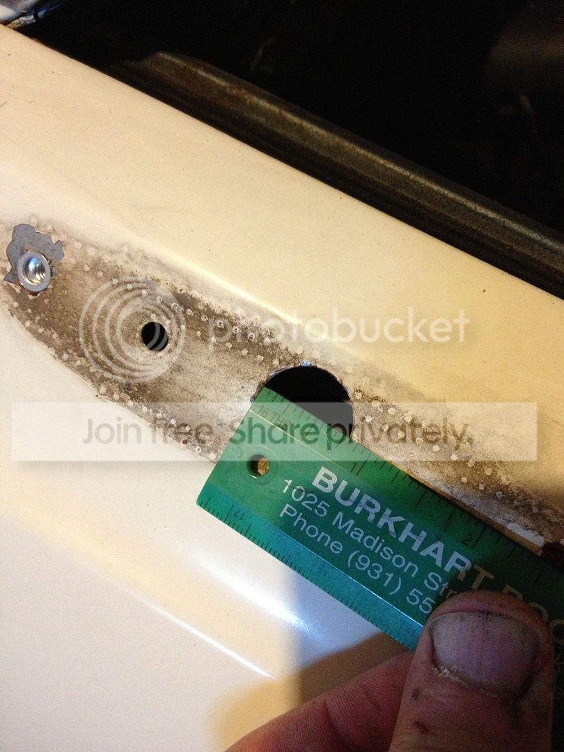

    Thanks again everyone I mounted the mirrors today They Look Great & Predfan I used AK gaskets the only problem was with the cables I had to remove a little of the gasket from under the mirror. But other than that They worked Great. & Yes Craig they are much more flexible then the originals. I'll take pictures tomorrow.
  13. mav1970
    Could you tell me what size hole is used for the cables? I'm adding sport mirrors to my doors and both are adjustable so I need to drill holes.
    Thanks :Handshake
