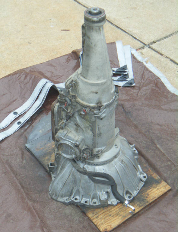

    Pics attached. Just has your average grime and filth on it.
    I want to clean it up, maybe even paint it, but how can I safely wash it down?

    I cleaned mine up by rubbing it down with a lot of Simple Green, then covered up all the holes with rags and tape, and took it to a coin-operated car wash. Pressure washed it there, then I took it back home and cleaned all the more difficult areas with brake cleaner and more Simple Green.
    Trans on the left is what came out of my car, trans on the right used to look like that before I cleaned it up. This is right before I discovered I needed to swap bellhousings...

    Mine wasn't too dirty to begin with. Hope carb cleaner and paint brush doesn't hurt anything. Didn't get it in any holes.
    This looks clean enough for me at this time.
