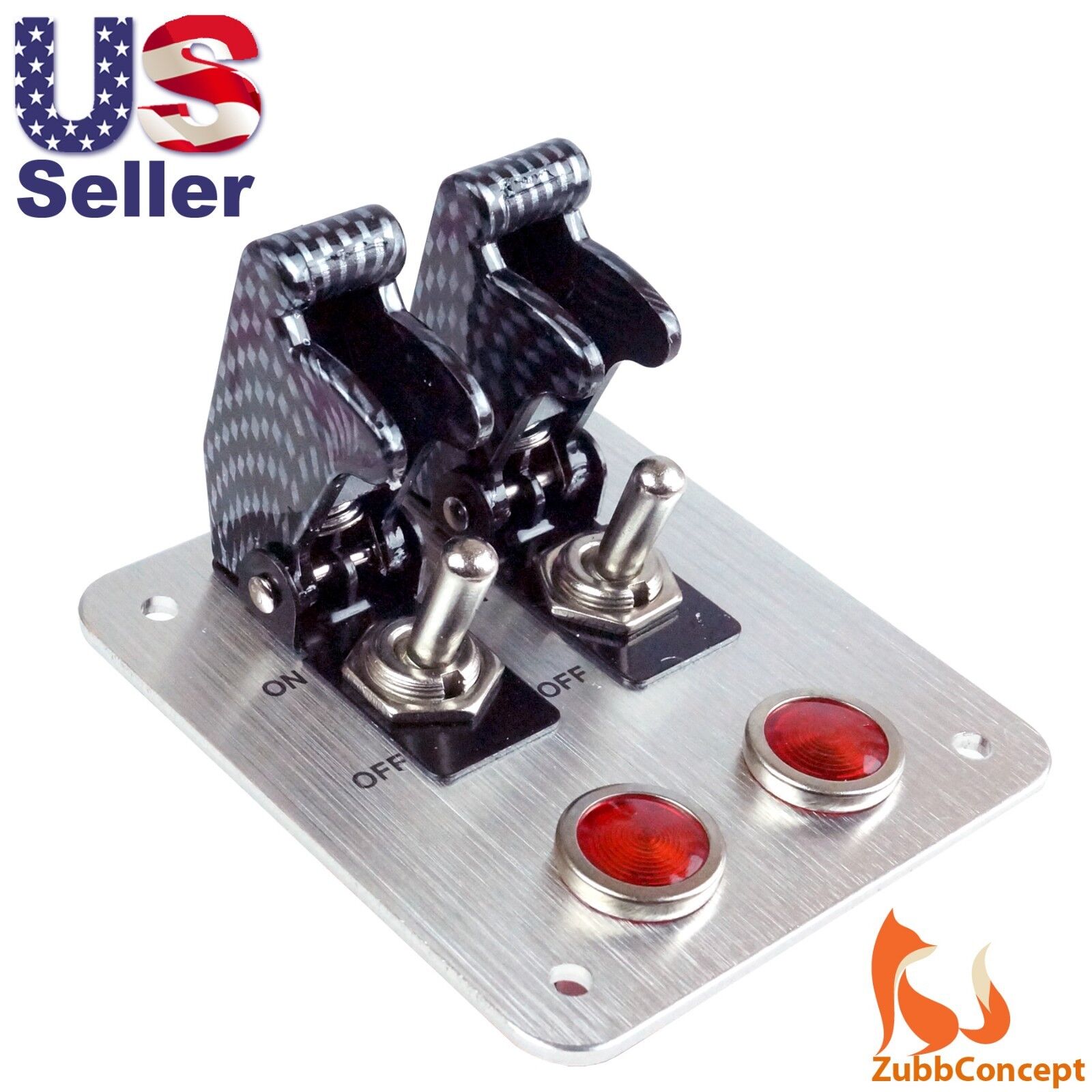

    well fuse #1 which is for cig lighter/flashers/clock seems to have 12V all the time. Im gonna pull power from the feed (before the fuse) side and put in a fused switch to just let me turn on the module and the elec fan relay. I prob need a way to turn off the elc fan if im on ACC anyway. Plus maybe I can get a cool looking switch like this, LOL...
