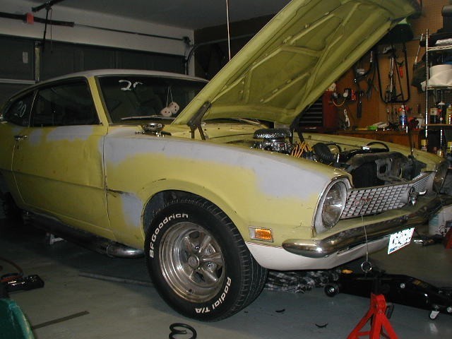

    These are mine when I first installed them. Those tires are 255/60r15...my REAR tires on the front. Before and after.
    The gasser look!!!
    After one coil cut...
    And then after I cut off a bit more and put the front tires back on. I think those are 195/60r15s.
