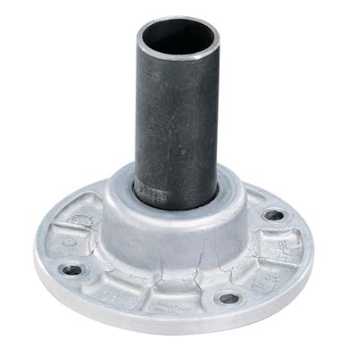

    Make sure to check the T5 input shaft bearing retainer....Originals were notorious for wearing out where the throw out bearing rides on it....Better steel one's are available
