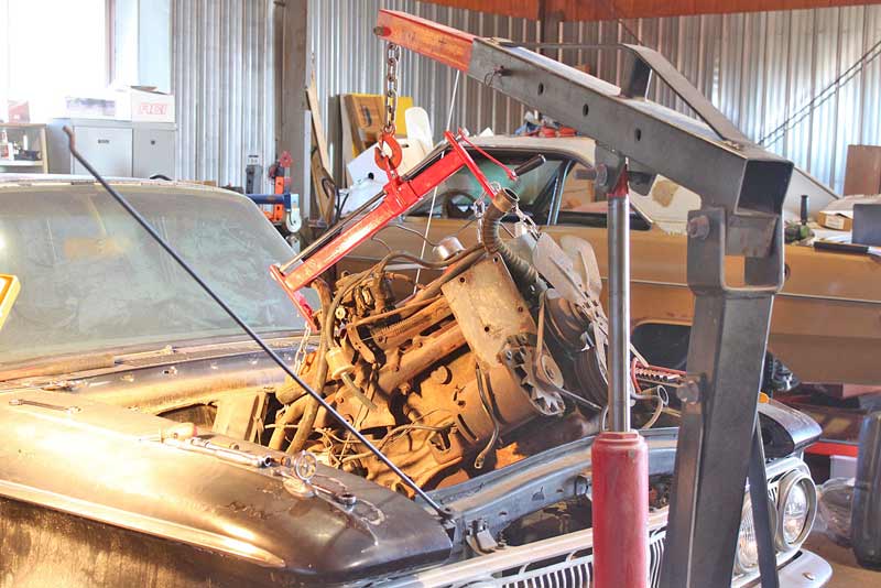

    Made a little bit of progress, fuel, electrical, headers.... feel like it's going to have plenty of room.
    Pulley's next! What I am dreading is that once this is all out... I should really fix the rusted cowls. What a snowball.

    Wait until you have the patch panels before you start cutting. But no better time then while the engine is out.
