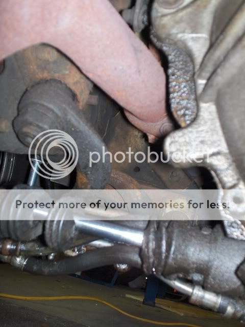

    Heres a picture of what my car looks like up in there, not as clear with the power steering stuff in the way. I also found this while digging around the net, www.tffn.net

    I'm just thinking, that if the socket that connects to the collector could be dimpled enough to allow full travel, it shouldn't really restrict flow, heres a picture (off a falcon, same headers) with the socket removed, the header is above the steering arm, is more or less just the exhaust pipe that will need to be adjusted to clear....

    Looking at that pic, it seems to me that all is needed to be done (by manufacturer) is point the collector back at more of an angle. If it didn't point down quite as much, the attaching pipe should shoot right over the steering, as opposed to right into it's path of movement... or swing of the pitman arm.

    Your pic here illustrates my point.
    See how it's angle of attack is much shallower compared to the shorty collector?
    If the shorty went at that angle, we wouldn't be discussing it.
    Look at this pic and the pic of the shorty collector going much deeper and right into the pitman arm.
