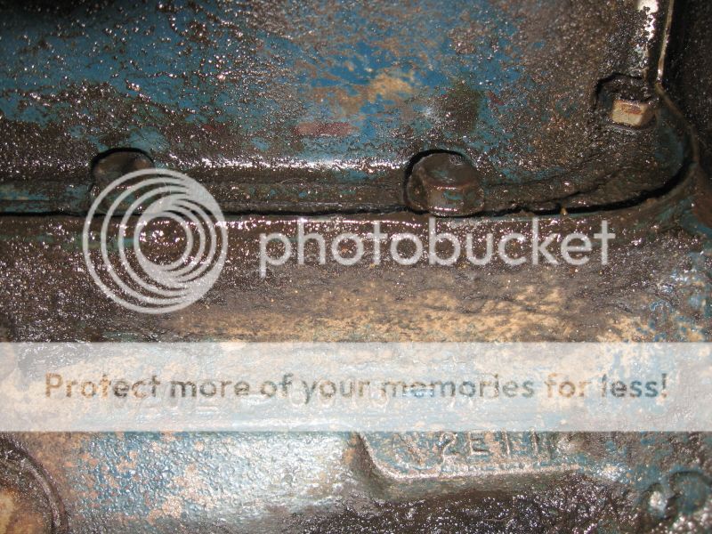

    Ran the numbers on the engine, it appears to be originally a 302 from an early spring build date 1972 Gran Torino.
    3/24/1972 I believe.
