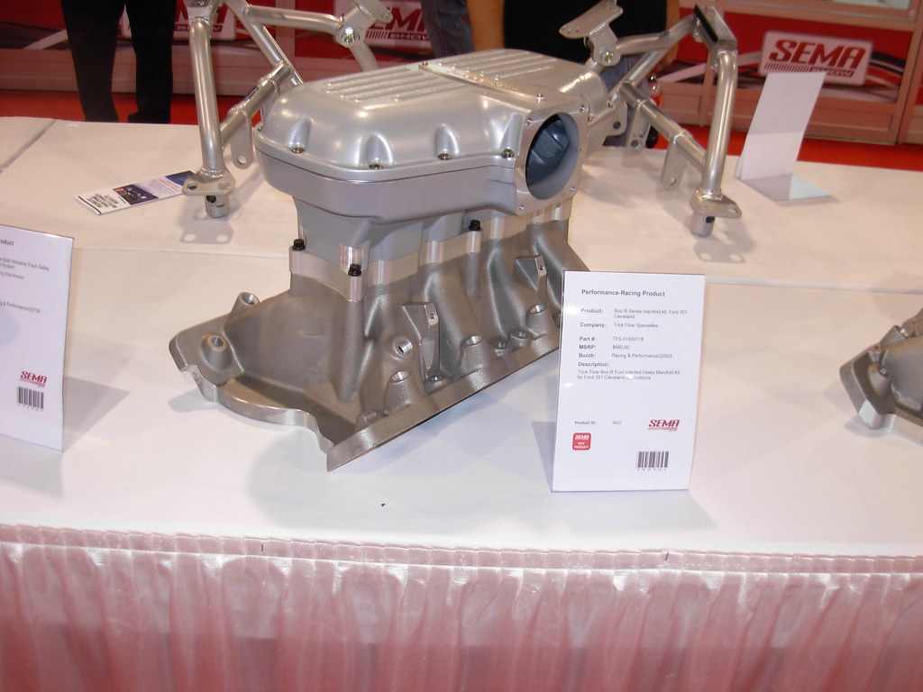

    TFS claims they are about to release 5.0 style intakes for Clevors in about a month...
    This is one of the Cleveland versions, but they claim the Clevors are coming too.

    I spoke with Cory Roth of TFS at SEMA this year and he mentioned these. Clevor stuff is done. They're just going through the pricing/availablity/distribution meetings before they release them.
