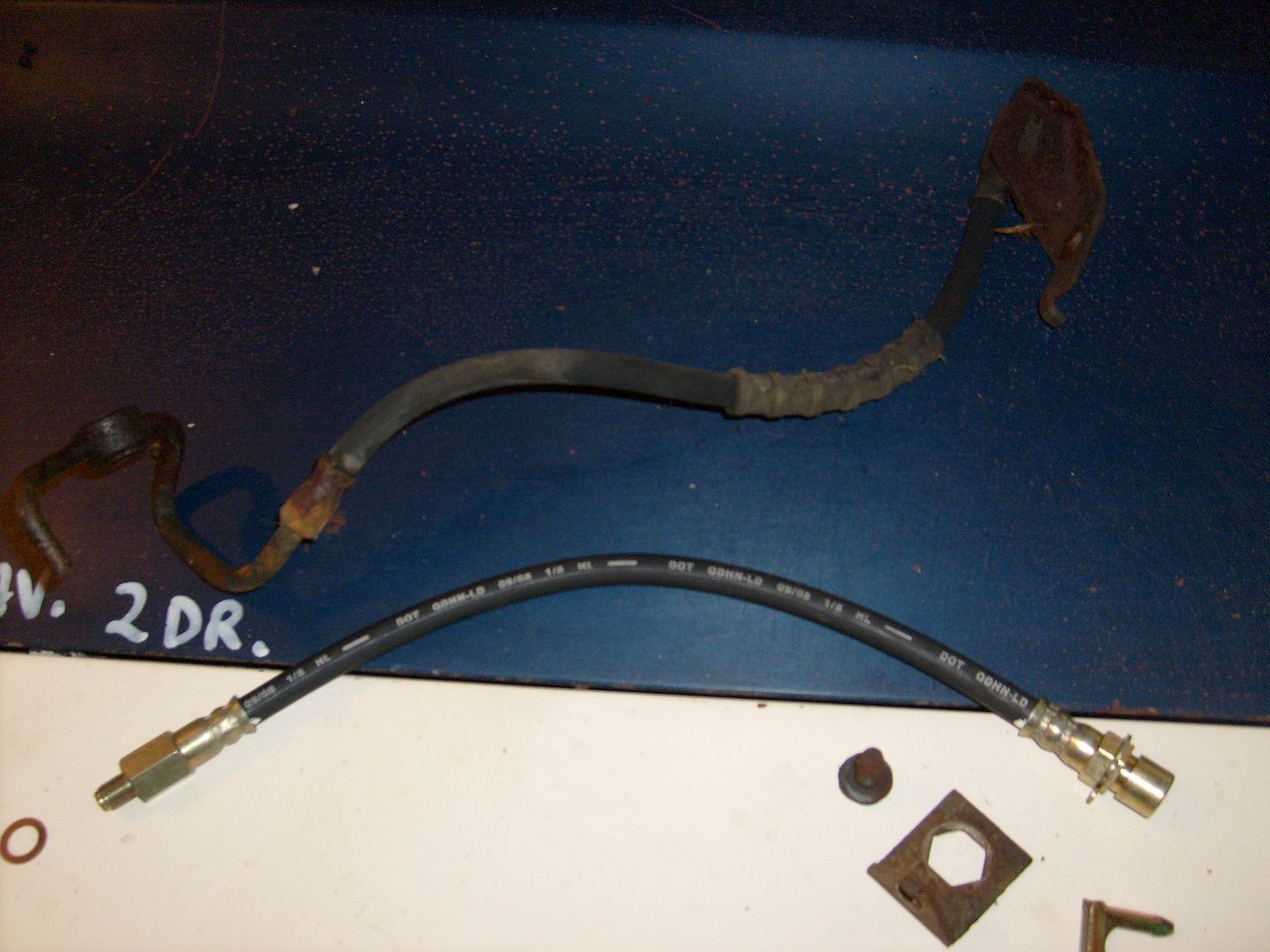

  13. predfan2001
    Got the Mustang brake hoses and brackets on and hooked up.
    Old stock hose vs Mustang hose...those are 68 Mustang brake hose brackets below. They are required to mount the Mustang hoses to the frt frame rails between the control arms for the Mustang hoses to mount to.

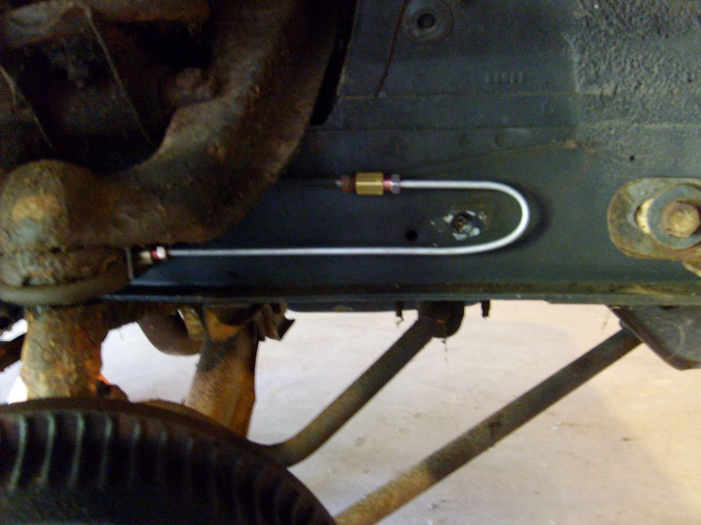

    Making a line to connect the Mustang hoses to my original lines. I'm flairing the lines and using a connector...I'm not a fan of compression fittings.
    I tried to make a nice radius in the line, but ended up having to bend a little different when mounted...oh well it will work fine.
    Getting closer to being driveable....then I'm gonna test the mechanicals....then start on the frt end and interior.
