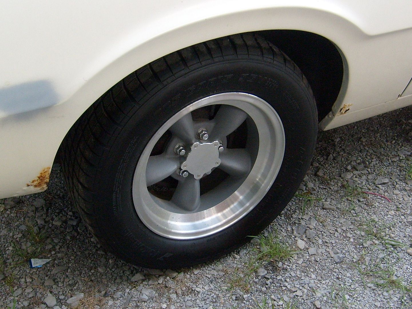

    Worked my tail off today and sweated about 5 gallons...but I cleaned up the garage and temporarily moved my Cyclone outside so I can work on the Maverick inside. About all I actually did to the Maverick today was put on the flat center caps on the rear....they finally came in.

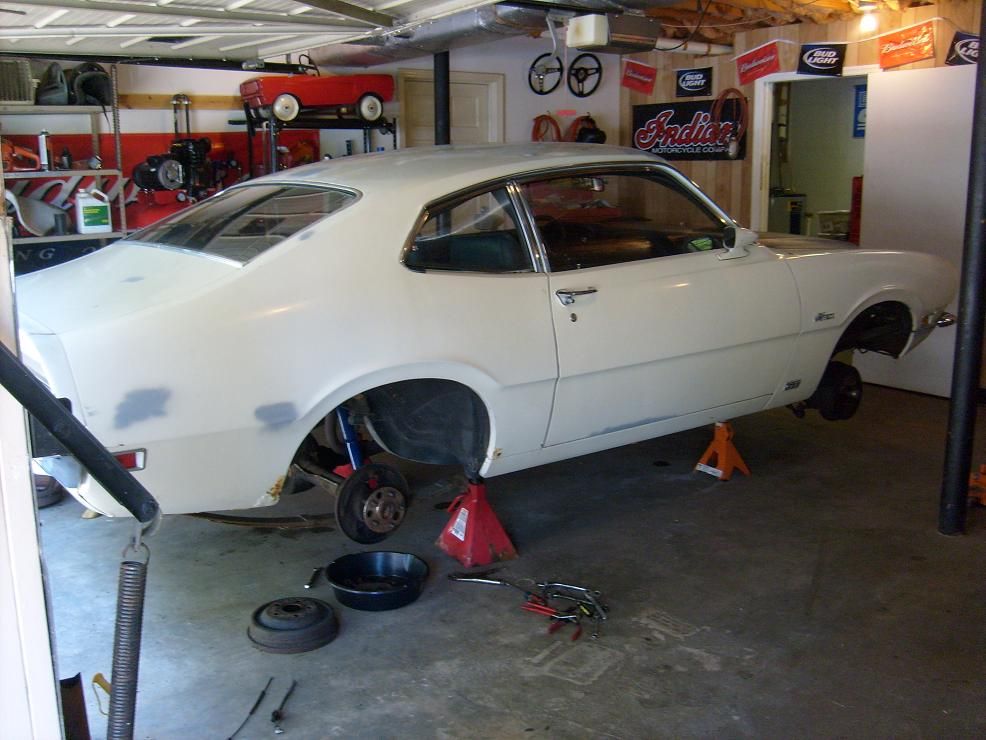

    So nice to NOT be working in gravel! Started tearing down the rear brakes and after letting a little penetrant soak...every fitting came loose with no problems. Thanks to who ever post the idea about using a fuel line clamp to get the parking brake cables loose...makes it sooo easy! I've got new NAPA parking brake cables and all new rear brakes and hoses going on as soon as I get this stuff cleaned up.
    Then I'm redoing the frt brake lines so I can use 70 Mustang brake hoses....then a new Wagner master cylinder. And if all goes well, I may actually have brakes!

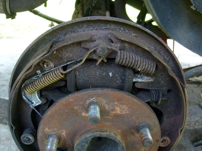

    Rear brakes are coming together....here's a before and after pic:

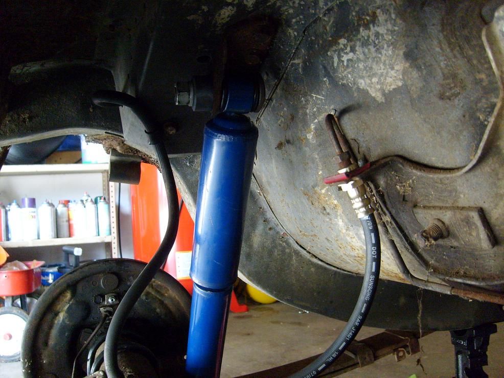

    Got the new rear brake hose on....since this is a 73 model Maverick rear end...that's what hose I ordered. I feared something might cause it not to work on my 70 model but it was a perfect fit. I also replaced the axle vent. The old one was stopped up and dry rotted.
