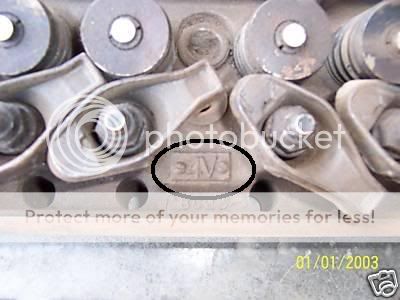

    Au contraire
    Technically that is not true.
    In 1968 the 2v heads change combustion chambers to the larger 60-63 cc. The 302-4V or J-code had the same chambers as the 1966-67 289 heads that were 52-54 cc.
    Clearly marked 4-V.:)

    I think in '68 there was a factory 4v 302 head... Not that it was special or anything.

    Yep,and there were 351W 4v heads too...in '69 only.

    I have never heard of any 4V Windsor cylinder heads.
    Do you have a casting number?

    No not really,but they'll have "351" and "4v" cast into them,similiar to the 302 heads pictured.I've only actually seen 1 set,on a '69 351W out of a Mach 1.
