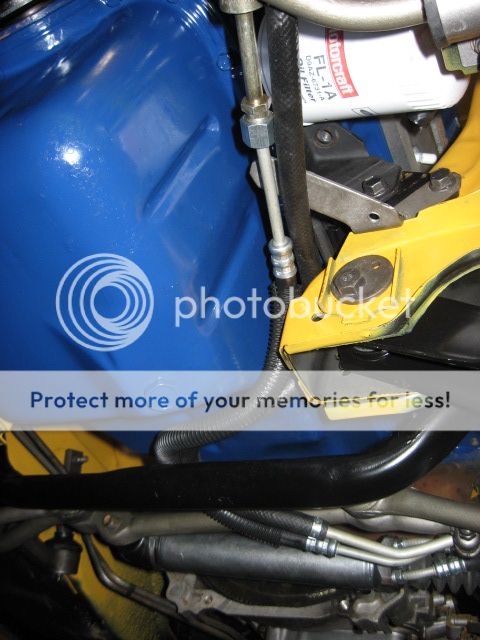

    Going straight down really gets into crowded territory...

    yeah I can see....great picture by the way. Well its starting to look more and more like Hedman 88400's for me. I have just heard bad quality issues on them. But I am going to hope something like your thorleys will pop up. So I am going to hold out as ling as I can.
