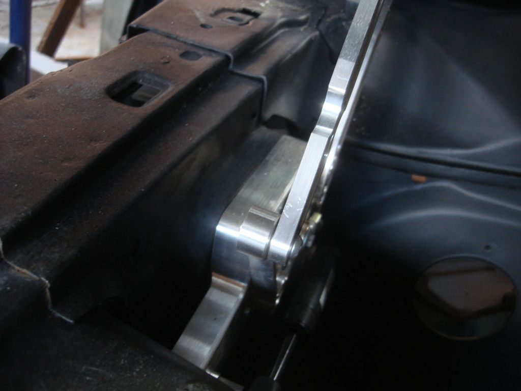

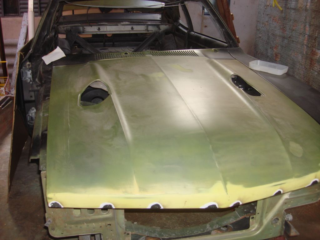

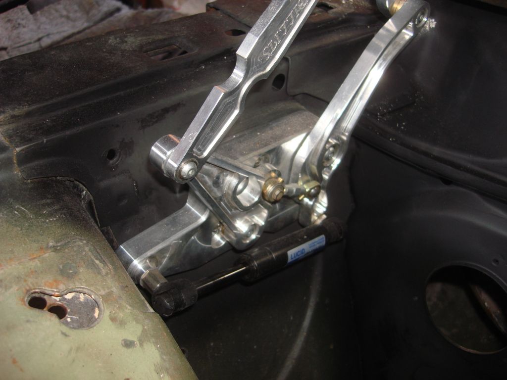

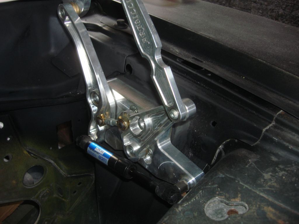

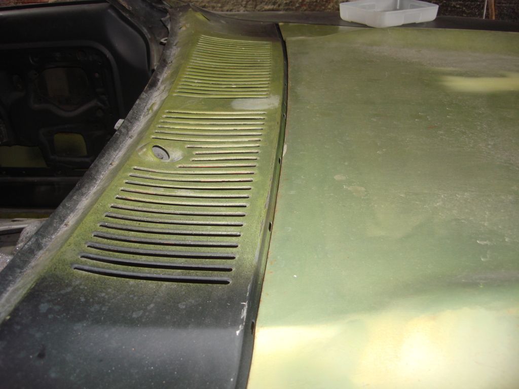

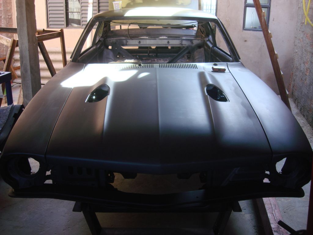

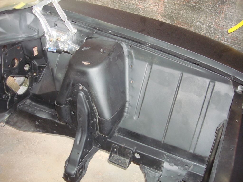

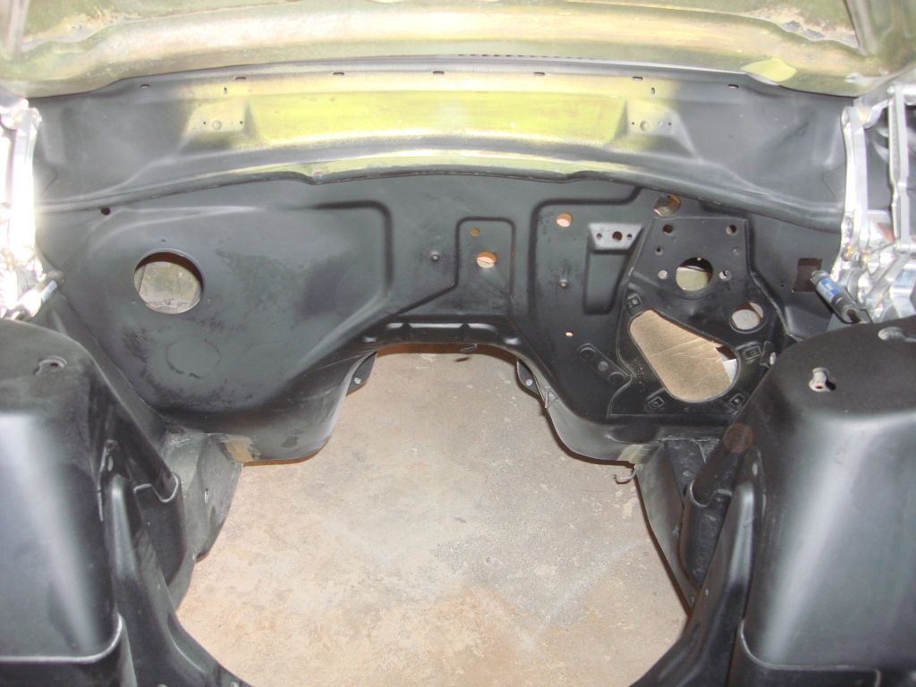

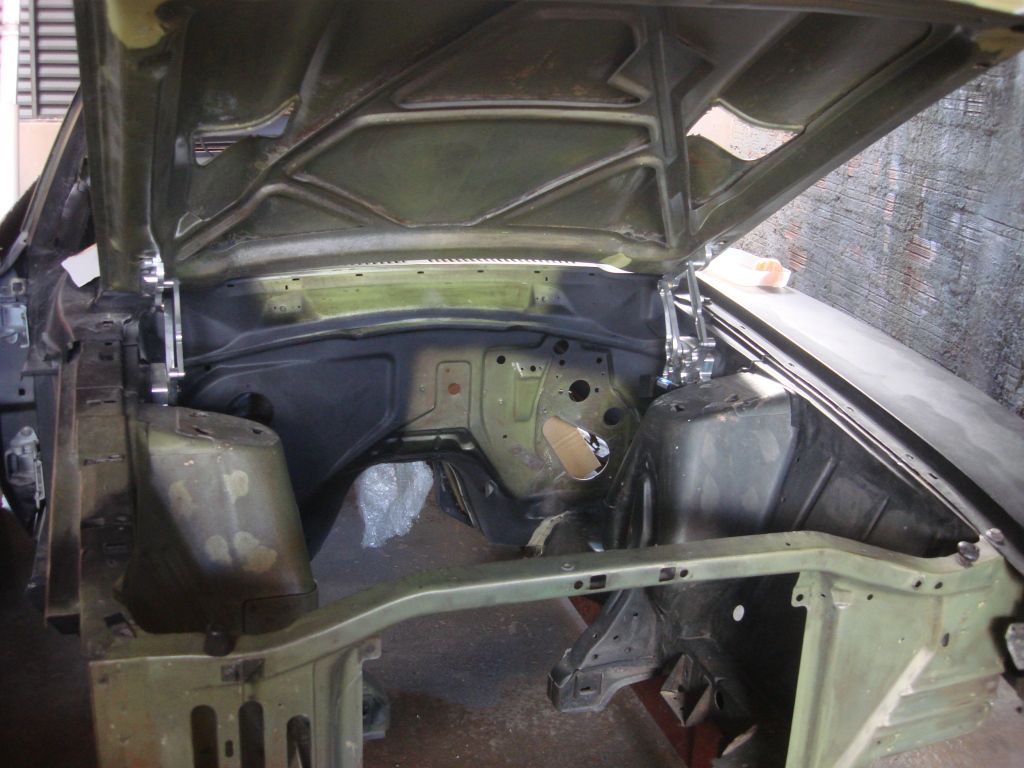

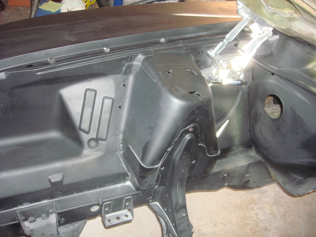

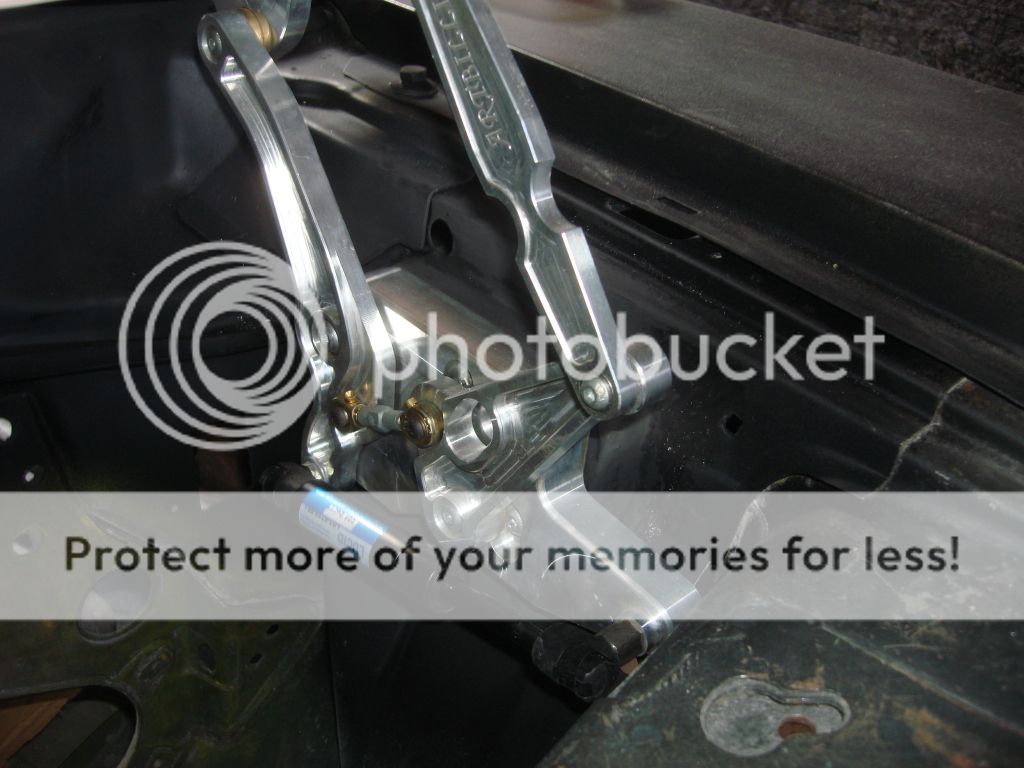

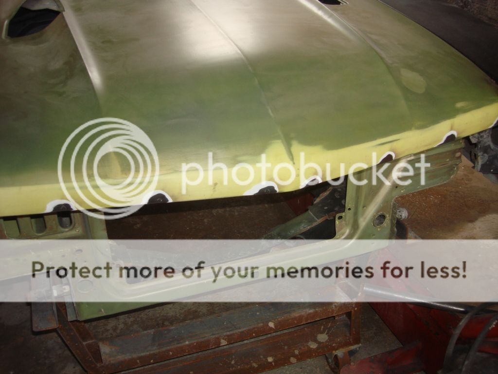

    after four long days...Hinges base plates: done!!
    alignment of the hood: Done!
    plug all the holes left over: Done!

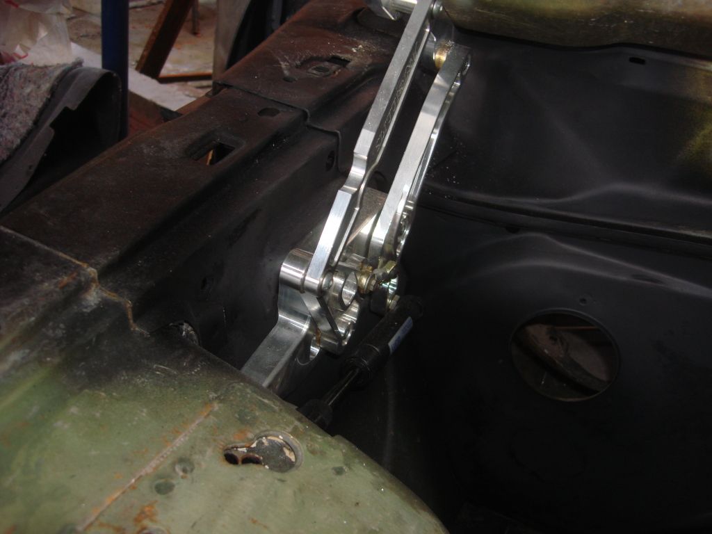

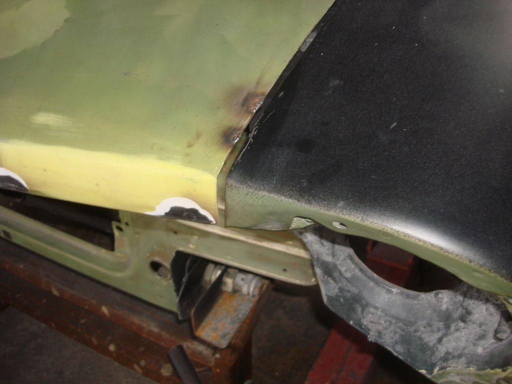

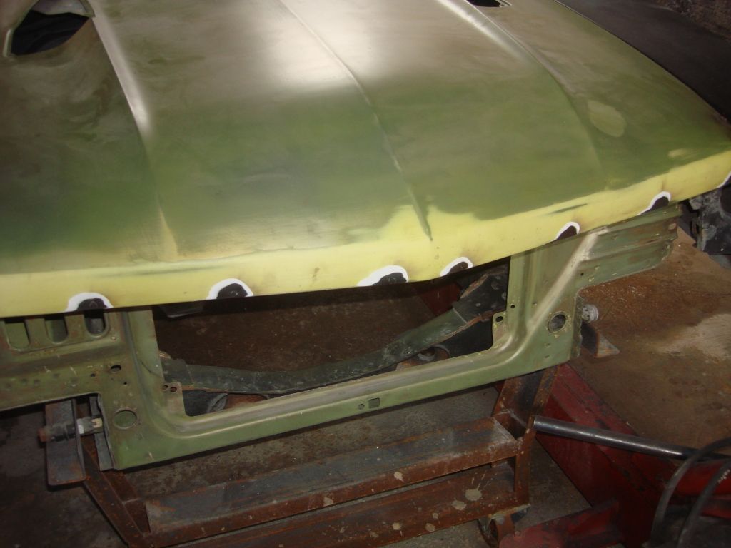

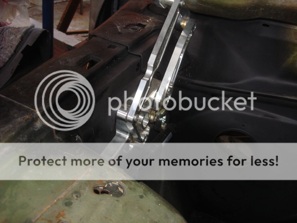

    I contacted the individual that makes the hood hinges and he tells me they are plug and play. Looking at your posts they do not look anywhere close to plug and play. Do you have to modify the hinge mounting area under the hood to get these to fit correctly?
    Thanks
  9. topolino
    topolino Member
    Sep 21, 2011
    487
    Brazil
    when I bought he tells me they are plug and play also..but many mods are necessary for sure..a lot work..we spend 4 entire days changing place of holes..both, hinges and body...filling with metal the base plate,hood alignment .. a lot work! but now i think was worth it :thumbs2:
    If you are thinking of installing in a running car , I do not know if it's worth ... but if you're building one, as is my case, perhaps it is.:huh::thumbs2:

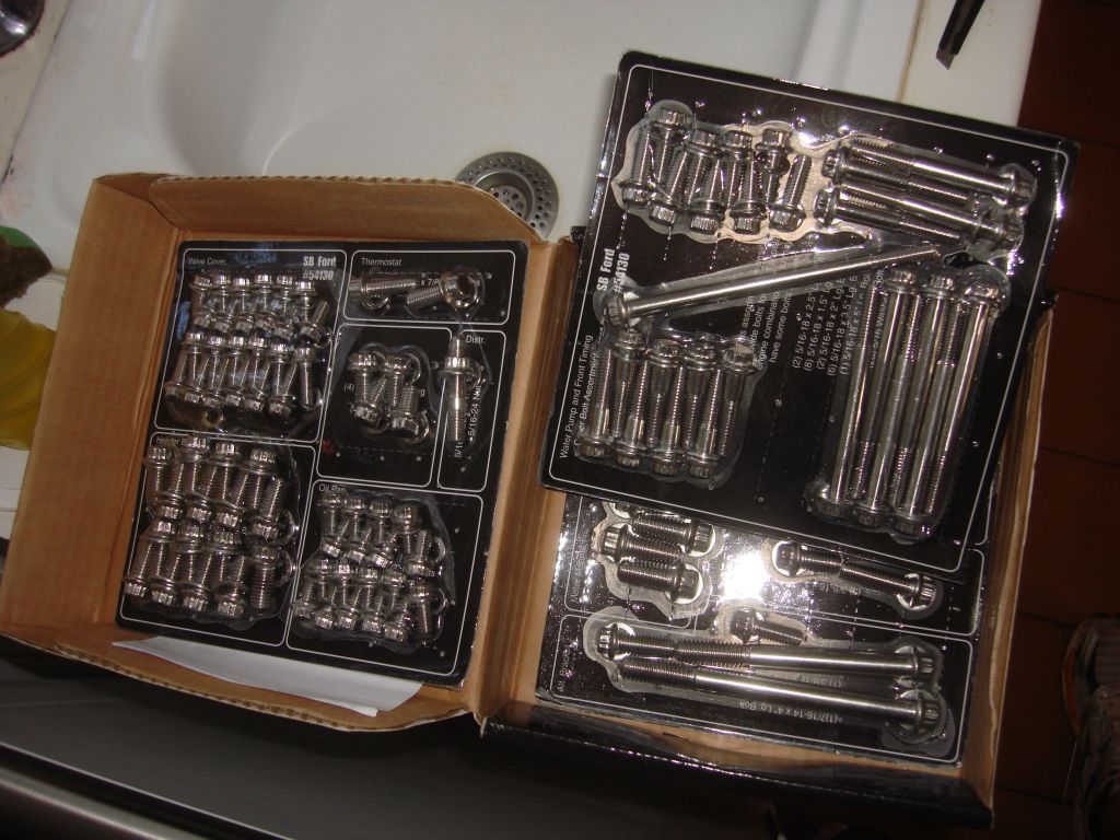

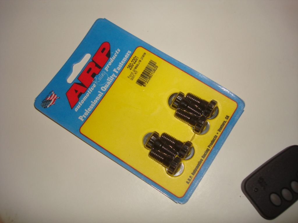

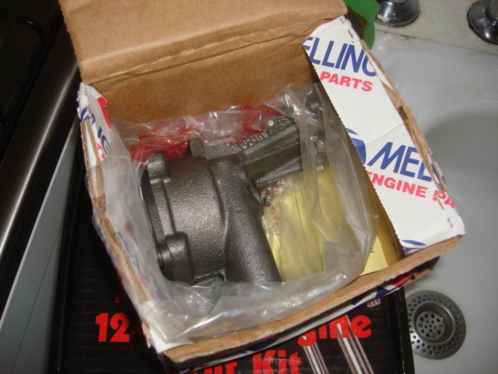

    I love X-Mas !!!
    got power?!?!:dance::dance::dance::dance:
  11. junrai
    junrai Member
    Dec 26, 2011
    2,516
    196
    rancho cordova ca
    :D:naughty::yahoo::yahoo::yahoo::yahoo::yahoo::yahoo::yahoo::
    holey crap!!! thats a LOAD of parts

    Why didn't you create a billet insert (aluminum spacer), instead of cut and weld? It came out super nice in the long run, just curious if you had thought of creating the spacer and then gave upon the idea for some reason?
  13. topolino
    topolino Member
    Sep 21, 2011
    487
    Brazil
    LOL ... a LOAD!! :D:D:D:D:D:D:D:thumbs2:
    I did not do an insert because the wall is not a right angle .. is a bit skewed. and would be more complicated set the correct angle .. without putting in some insert shims. and also I wanted to leave "as if" original

    You got a grabber hood! Kudos man!! Loving your progress pictures!:thumbs2:
