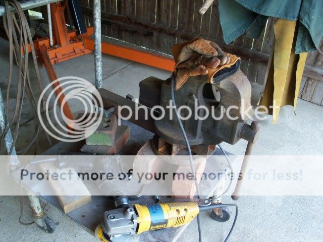

    For cutting, a 4-1/2" 'Angle grinder" with a 1/8 " cutoff is most most dangerous and most useful tool in my shop. It is the basic part of my 'machine shop' and swapping a grinding wheel for cut-off doubles its usefulness.
    I've tried knock-off HF's and others and none have the power to cut or grind compared to an inexpensive DeWalt . I'm sure there are other equal grinders but I would hesitate to waste time with a cheap low power version of this incredibly useful tool. I have a DewWalt Battery type grinder for remote or quick use, but it has much less power than the corded 120V.
    BE CAREFUL!, Angle grinders are notorious for causing serious injury when used just a little unwisely...
    have fun
    the 'machine shop' :
