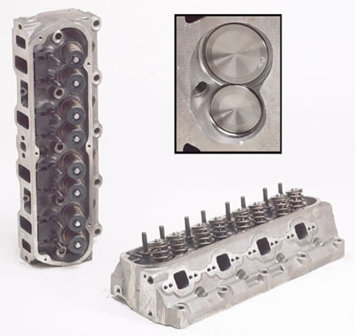

    Ok guys it's been a few weeks but i managed to find the time to go pick up these heads. The only numbers i have found are N 91 5 5 and 624 H.
    Heres some pics that mabee able to shed some light on the subject.

    World Products Windsor SR heads IMO.
    That would account for the big "W" under "Windsor"
    If they were Windsor JR heads, I would think you would see "JR" somewhere.:huh:

    Hold on...
    Do the head bolt holes have removeable bushings?
    If so, they could either be JR or SR...
    But if the holes are cast small for 302 head bolts, then they are JRs.
    I can't quite tell from the pics. The holes are small, but I can't tell if they are bushed or just cast small.

    I took a good look at them and they don't appear to be bushed and stock 302 head bolts fit right. Cool thanks for the input.

    99% sure they are Windsor JRs by World Products at this point.
    If that is the case, they should have around 60cc chambers and 1.94" valves.
