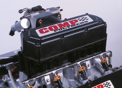

    They would indeed...I used to have that exact intake (I sold it). The lack of tuned runners affected the low end torque...that intake seems to be designed more for high RPM racing, and my car is more of a cruiser. :) It also does not have provisions for an EGR valve...not a big deal, but at the time I didn't have the Tweecer to make tuning adjustments and I wanted to keep as much of the factory stuff as possible to help make it run right...

    Just put a intake on it like this one, then the tower braces should clear no problem.

    That intake came to mind as well.
    It will have the same or higher rpm power band as the Comp intake though.
