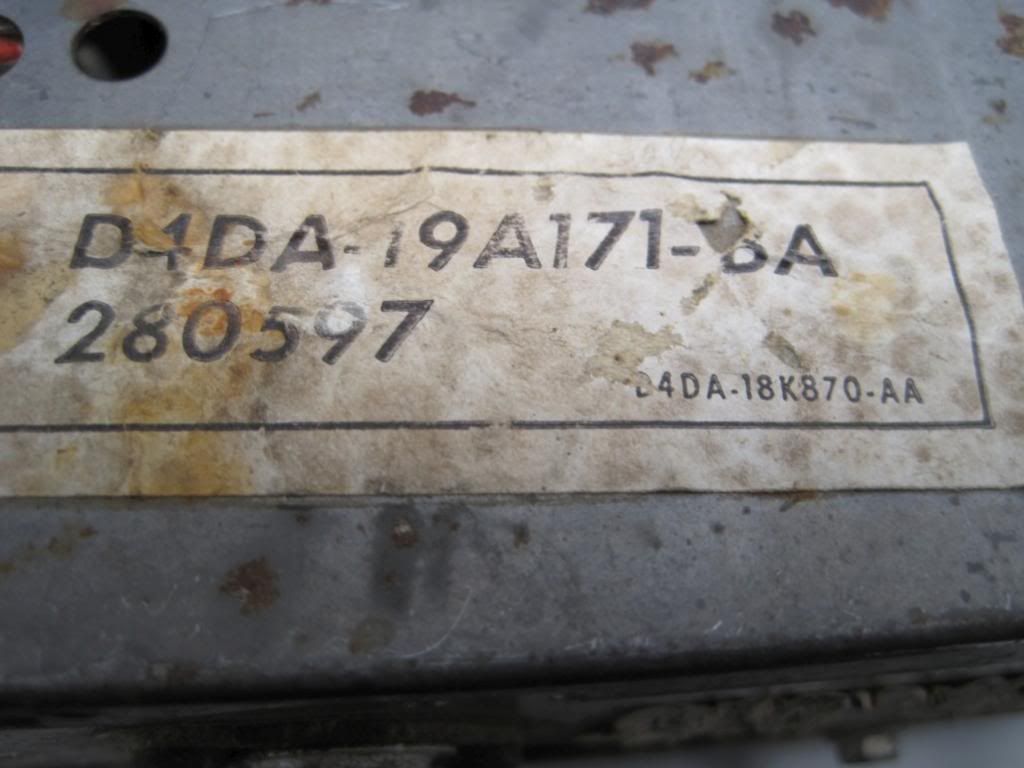

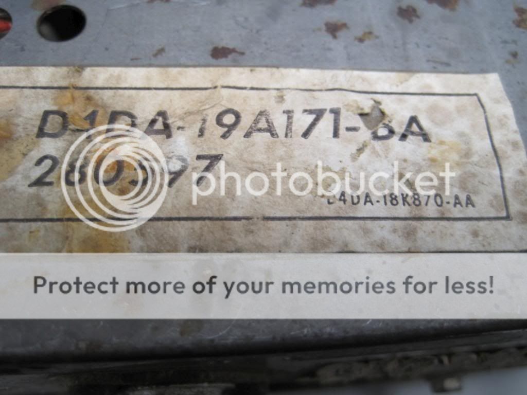

    My buddy sent the radio to my shop for testing. He was mistaken about the part number, it is a 1974 part number, it has a tag marked D4DA-19A171-BA.
    Anyone have a wiring schematic? The plug is missing.

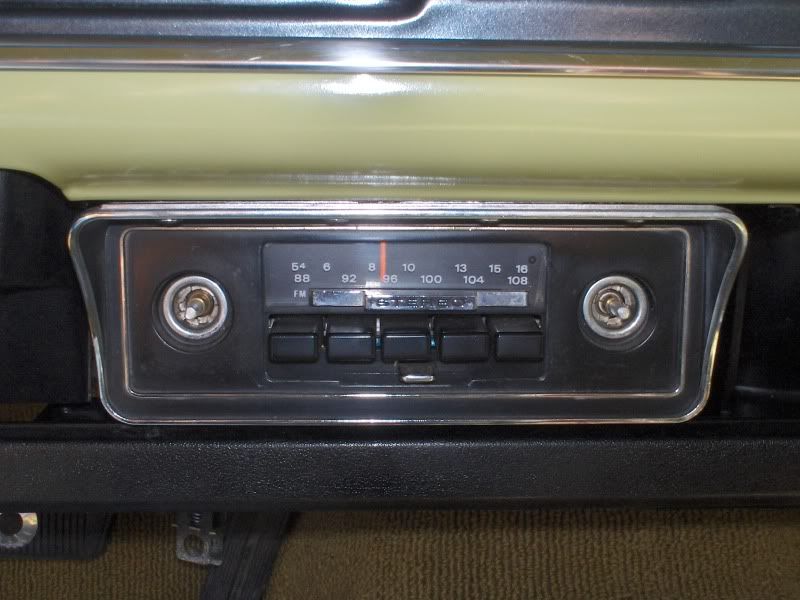

    Here's a picture of my 73 am/fm stereo, I can get the part number off it.

    One of the guys figured out the wiring. It works, single channel mono.

    I have only seen one other '73 Maverick AM/FM and it didn't have lines on the dial either. It's odd that the 'other '73 models like Torino & Mustang had the conventional dial with the separator line and hash marks. I wonder what dictated the unique face plate for the Mavericks.
