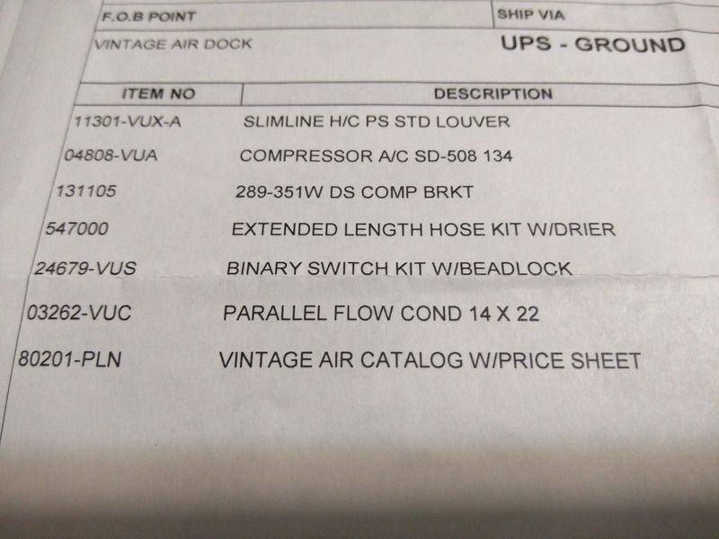

    What Vintage Air Kit do you have? Thanks, Mike

    I can get numbers later. It's basically all universal parts other than compressor mounts.

    Did anyone ever come up with what part numbers were used or what kit number?

    Mine is a 11301-vux-a, I cut off tray after radio and installed in its place. This was for a 302.
