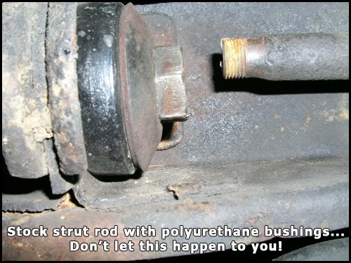

    Hope it all works OK but I am curious to see how this works on the street. I would think its going to be very harsh with no rubber on the strut rods. I could see it for a race only car. HAve to wait and see how it rides I guess??:huh:

    I rebuilt my front end with all PST Poly Graphite stuff back in `92 When all of the car mags were raving about how great polygraphite stuff was. Later on "Internet" happened and I started hearing about how it was not good to have the stiff bushings in the strut rods. I`ve seen alot of people have the rods break like in the picture Darren posted, and Its always in the back of my mind "What if I launch at the track ,and when my front end settles back down one of my strut rods breaks?" Into the wall or another guys car I go! I`m tired of worrying about it so I went ahead and ordered them....SO....One less thing to worry about.:dancing::thumbs2:
