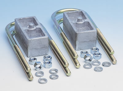

    You can go to AutoZone (or a similar parts store) and get a lowering kit (Drop Blocks) for a leaf spring car. It comes with the spacer blocks and U-bolts. It's less than $30 here.
    Not too much trouble to install them (directions on blister pak). I'd make sure that you can actually go lower - and measure by how much.
    Good luck.
    update: found them at summitracing.com

    As for your second question; there are two ways to drop the rear. One is to install spacer blocks between the rear axel and spring mounting pad. You will need longer U-bolts to do this. This is also the least expensive method (that I know of). The other way is to have a spring shop re-arch (or de-arch) the leaf springs for a lower stance...

    I might look into those lowering kits to level my rear end out...maybe grind on them until one is 1/2" thick and insert it to drop only one side. Hate to do it that way, but that seems to be the only way to get my rear end to stop leaning...

    Lower the front by cutting the springs, lower the rear with those blocks that Rick showed a couple lines up.
