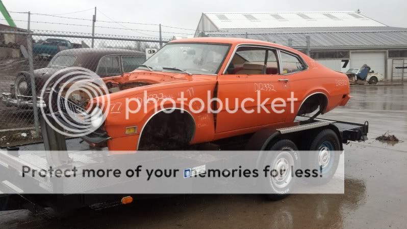

    Got a hold of a 77.....there are many good sheetmetal parts here...going to use the rear quarters and rockers...the yard said it was from Arizona...lots of surgery on the Stallion ahead...hopefully the weather will break...endless winter here in MN.

    Man....I know you have a lot of work in the other car, but might be easier to move the Stallion over to THIS body.

    the car is bent...otherwise it would be a shame to chop it up...now it gets to be used to help get mine on the road...

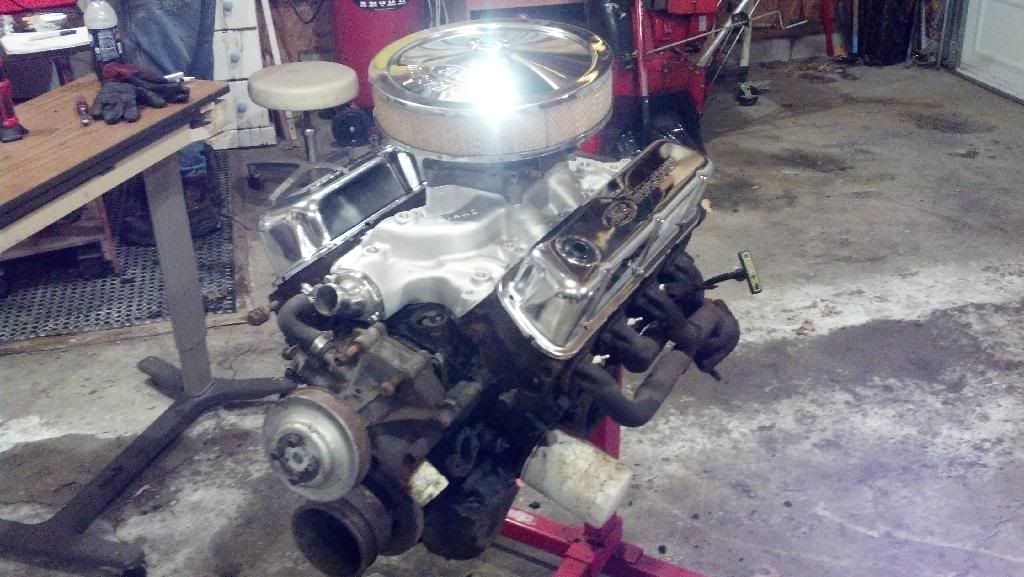

    got the 1987 mustang 5.0 on the stand...
    keeping it simple I will be running a carb and some oldschool motorsport bling...
    picked up some GT40 heads and intake...will be using the 40's with the carb...the fuel injection is to be installed later...

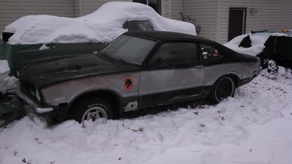

    to say the winter here in Minnesota has been harsh is a understatement...started to dig out the Stallion today...
    got it dug out...
    I will pull it out and get it into the garage this weekend...
